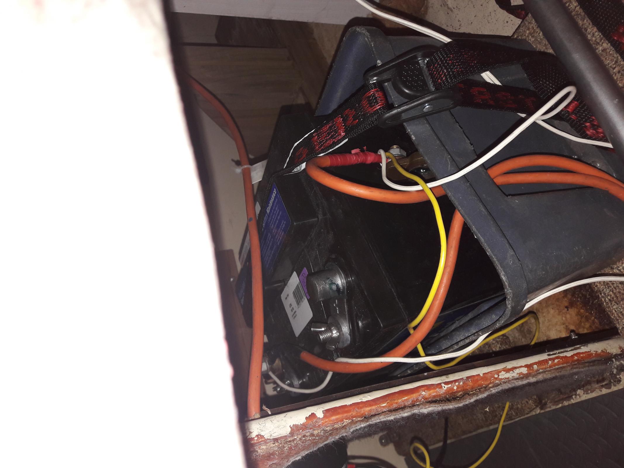

Damienmumu 0 Posted December 10, 2017 Author Share Posted December 10, 2017 Thank you Fish. Here are a few photos I have just taken tonight. Actually I thought I drained all the water but I can still hear slushing in the rudder... Below are photos showing when tip the rubber back, you can see water drain at the fron of rubber. it is only coming out in one point, not sure how long is the opening/split though as water runs along the edge: I am unsure what the Farr 6000 rudders are made of though... Electrical panel... old school: Solar panel regulator: Battery: Solar panel: Quote Link to post Share on other sites

Damienmumu 0 Posted December 11, 2017 Author Share Posted December 11, 2017 Thank you Fish. For the rudder... decision taken, I am bringing it to Norski tomorrow to get it repaired, they can do it this week, perfect. I appreciate your safety advises as it is most important after all. For the electrical system, it is not new but generally tidy at least for the panel... I will check phone charger and get Matt to look at over all system in January. For the solar panel, I know understand now it is not a great panel...! Thanks again! Quote Link to post Share on other sites
