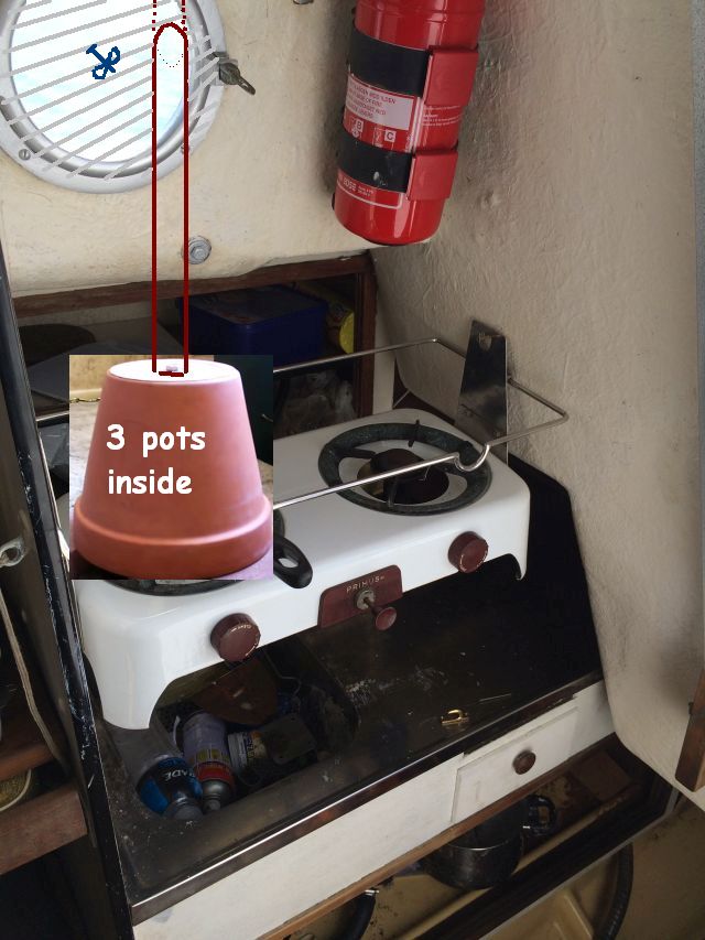

erice 732 Posted April 10, 2016 Share Posted April 10, 2016 gleaned from the net an inside pic of a taylors cabin heater the outer panel has been swung open, the kero burner's pre-heat cup has been filled with meths, lit and due to the yellowing of the flame (+40sec?) appears about ready to burn out just as the kero valve should be opened to allow pre-heated and vaporised kero to flow to the burner and burn with a nice clean blue flame the black canister above the burner must contain a metal baffle system to hold and radiate the heat while allowing the fumes to rise up and out of the boat through the 25mm stainless pipe at the top if you've already got a kero stove with the same pressurised burner system in your galley it looks like you could stack some clay pots on top, drop a flanged? exhaust tube (old vacuum cleamer tube? or even 25mm square desk leg) into the top hole and run that out your galley hatch/window? (through an inside-outside fibrolite - hardiplank? blank that sandwiched the open port and held together with a through bolt + wingnut) might experiment this winter in the set-up above you'd want to run the stove on the stable bench-top instead of the swinger Link to post Share on other sites
