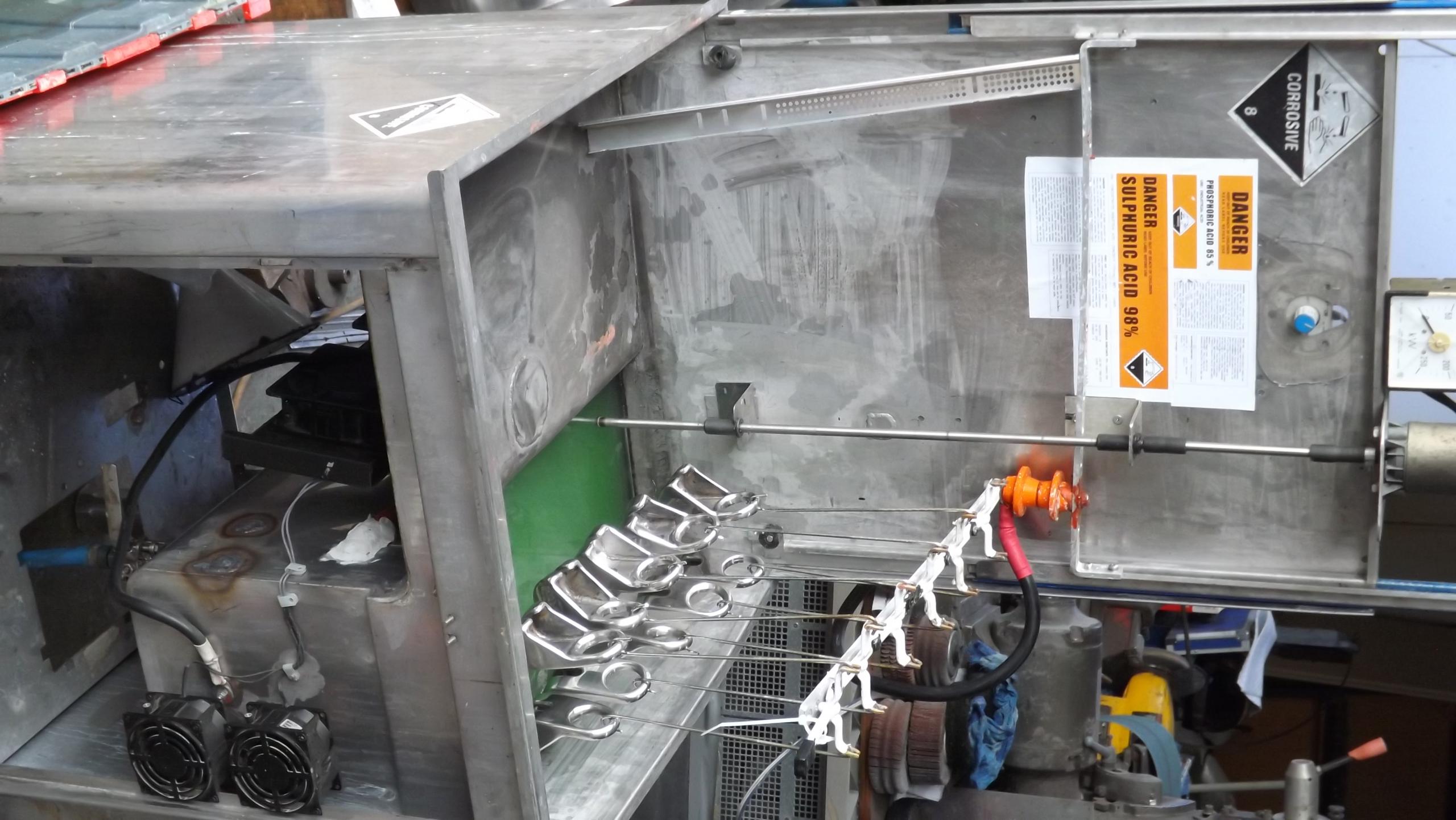

wheels 544 Posted September 4, 2016 Share Posted September 4, 2016 I built myself an electropolishing tank to polish SST. I can also Anodize Aluminium parts in it as well. It's been a lot of Fun. It is capable of producing 600A at 12V Link to post Share on other sites

Dtwo 157 Posted September 4, 2016 Share Posted September 4, 2016 Are those anchor chain hooky things being polished there? Link to post Share on other sites

wheels 544 Posted September 4, 2016 Author Share Posted September 4, 2016 Are those anchor chain hooky things being polished there? shhhhh, top secret...but yes. 8mm ones. Link to post Share on other sites
wheels 544 Posted September 4, 2016 Author Share Posted September 4, 2016 a lot of effort to make fancy beer can holders??? Close...bottle top openers. Link to post Share on other sites

Freedom GBE 27 Posted September 4, 2016 Share Posted September 4, 2016 Very cool 600 amps at 12 V. Does it draw 7000+ watts. That's my limit with electronic knowledge. A bit scary. That would blow a few fuses and heat up the wires. Link to post Share on other sites
smithy09 50 Posted September 5, 2016 Share Posted September 5, 2016 Nice work wheels. Not sure about the TIG welding on those hooks. Looks a bit like MY efforts!! Link to post Share on other sites
wheels 544 Posted September 5, 2016 Author Share Posted September 5, 2016 Looks worse than they are smithy. Although on the little ones shown, they are very difficult to get into to weld. But that pic is before polishing, so it is showing all the crap. Link to post Share on other sites

wheels 544 Posted September 6, 2016 Author Share Posted September 6, 2016 Do you make 10mm chain hook thingies? Yes there is a 10mm. 8mm is the smallest I make. Simply because it is too hard to get inside to weld anything smaller. Plus there are cheaper alternatives for the small chain brigade and often anyone using less than 8mm chain have rope to chain. 8mm and up tends to be more the all chain brigade. KM sells 8 right right up to 26 and the 26 is a hell of a lump of SST. The 8mm which are in the Pic are not made with quite the same love of finish as the bigger ones. Once again, due to size and also due to the real flash boats that want to show off " bling" tend to have chain of 14mm and up. They are not the cheapest thing, but there are hrs and hrs of work and every part is hand made from flat SST and then shaped and ground and welded and ground and then polished. I decided to try electropolishing because I was hoping I could get the things close to finish and drop the final hand polishing part. But I have found that is not possible. You have to get the surface down to 320grit to get a good finish. So that means you end up polishing them anyway. I will still EP them because it leaves a superior hard chrome rich surface over hand polishing. And it has been fun learning about EP. An expensive learning experience, but a lot of fun. I have made small changes every time I do a batch to make improvements. We put lots of time into developing them in the beginning. They are not just a simple hook as such. They have a specific break out loading, with the idea that the hook should let go just before the Chain (if it is a real chain, not Chinese) distorts. So the weld on the inside that smithy doesn't think is flash, is actually laid in there in a specific way to " cup" the link and support the side wall. When it does let go, it doesn't actually fail. The teeth splay outward and let the chain go and then you can press it back to shape with not too much loss in strength. If it is done once or twice at most that is. All other forms of hooks on the market tend to damage the chain once the limits are reached and there is nothing worse than a chain damaged part way down it's length. Hopefully this saves the chain, but if one is in that kind of blow, there may well be other problems anyway. Link to post Share on other sites
