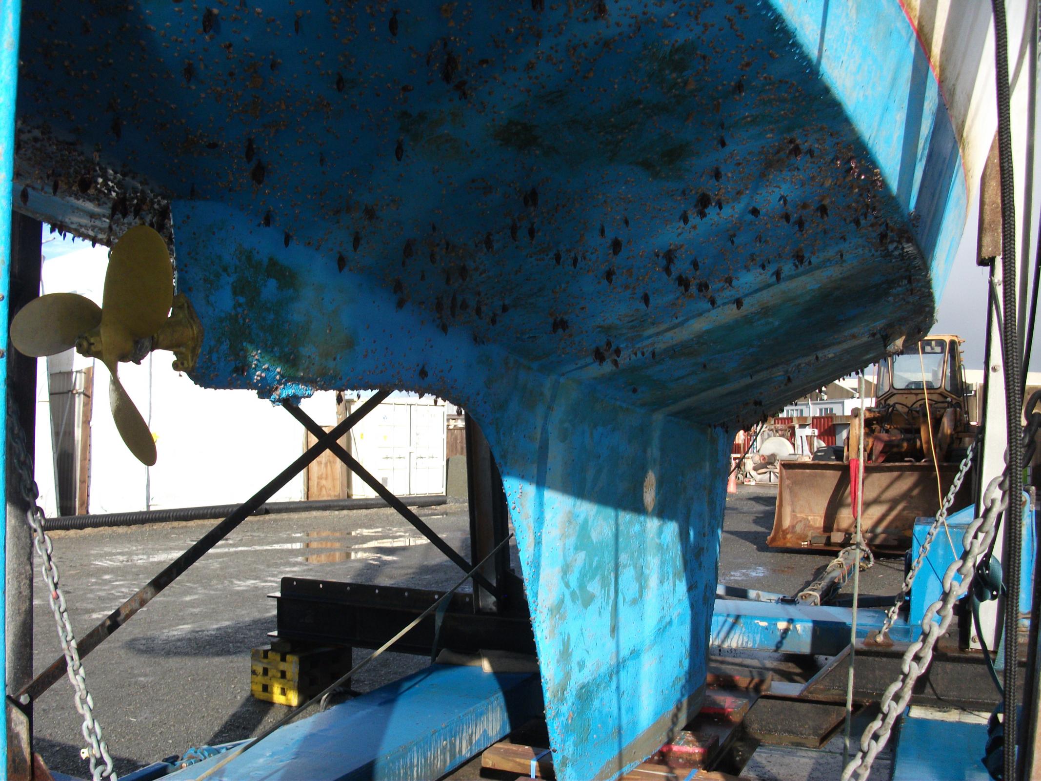

Crazyhorse 47 Posted May 13, 2018 Share Posted May 13, 2018 Will post a pic soon, but just hauled out at Norsand yesterday and WTF!!? We were given a half tin of vivid, a semi ablative and rolled it on December. Hauled put Opua to put in a new winch and touched up where it looked too thin ( they say put it on thin) then hauled out yesterday. Either side of the keel almost clean but the underside, an octopusses garden! Even a goose barnicle on the stern. Loads of little barnicles. Why? We left Opua same day we went back in and probably spent 2 weeks in Marsden Cove which is equally notorious for fowling (incidentally, they have given up fighting fan worm, they are everywhere). I know its used on alloy boats and probably for higher speed hulls (we get 6kts under power) but it seems very strange that there is little growth either side of the keel yet underneath the hull, quite a lot. Quote Link to post Share on other sites
Crazyhorse 47 Posted May 14, 2018 Author Share Posted May 14, 2018 OK, been told we shouldn't have used Vivid, its no good. Need to use a very 'soft' ablative? Any suggestions? Quote Link to post Share on other sites

Crazyhorse 47 Posted May 15, 2018 Author Share Posted May 15, 2018 I In my case Vivid worked very well in Lyttelton..be/nDgi-OM_Muo]https://youtu.be/nDgi-OM_Muo[/url] Up here the barnies are like bloody limpet mines! A big cat hauled out here today, barnies a lot less than us but still lots. Asked the skipper how long in the drink, 2 months! Jotun black on it.Now check this out. We had a little water getting into the deadwood ballast seam and use a product that refused to allow any antifoul to stick to it, so gave up and left it. When we hauled out in Opua, NOT A THING WAS STICKING TO IT! Slime yes, but no barnies. We decided to paint a test spot on the side of the keel and hauled out saturday and not a single barnie in it! Our dinghy spends a lot of time on the painter and fouls up so going to use it as a test subject and paint this "stuff" on it. Will let you know how it goes! Quote Link to post Share on other sites
Tazzy Devil 18 Posted May 15, 2018 Share Posted May 15, 2018 Up here the barnies are like bloody limpet mines! A big cat hauled out here today, barnies a lot less than us but still lots. Asked the skipper how long in the drink, 2 months! Jotun black on it. Now check this out. We had a little water getting into the deadwood ballast seam and use a product that refused to allow any antifoul to stick to it, so gave up and left it. When we hauled out in Opua, NOT A THING WAS STICKING TO IT! Slime yes, but no barnies. We decided to paint a test spot on the side of the keel and hauled out saturday and not a single barnie in it! Our dinghy spends a lot of time on the painter and fouls up so going to use it as a test subject and paint this "stuff" on it. Will let you know how it goes! Water has been super warm this year, I got 32 degrees in the harbour in Feb. Barnies have loved it. Even the clearer parts of the harbour are nutrient rich so barnies have been crazy. If you aren't diving the boat every 2 weeks to clean off the slime you'll get barnacles starting after say 4 weeks then after 5-6 weeks they get big and well stuck. None of the antifouls seem to work. The best option seems to be go for harder paints like vivid or ultra and clean regular. My experience seems to support this. Barnacles once on your hull, don't tend to fall off either. Quote Link to post Share on other sites
