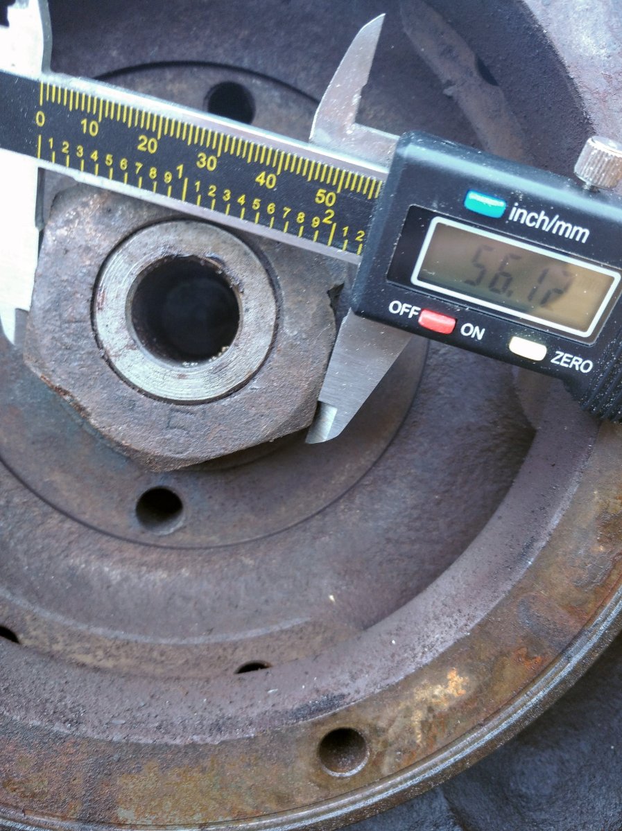

aardvarkash10 1,187 Posted April 4, 2021 Share Posted April 4, 2021 Bugger. Removed the gearbag and found the flywheel is retained by this bloody thing, not the five-bolt system it should have. Has anyone in Auckland got the correct socket or impact spanner for removing it? Extra brownie points if you also have the flywheel puller. Will pay in rum or cash! Quote Link to post Share on other sites
Island Time 1,360 Posted April 5, 2021 Share Posted April 5, 2021 I have an appropriate puller (hydraulic), but my biggest socket is 50mm... Try https://tradetools.co.nz/products/56mm-3-4drive-6-point-impact-socket Quote Link to post Share on other sites
wheels 544 Posted April 5, 2021 Share Posted April 5, 2021 It's usually undone by a Hammer and punch or chisel applied to the side of the nut. You can see where someone has had a go in the past. 1 Quote Link to post Share on other sites
wheels 544 Posted April 5, 2021 Share Posted April 5, 2021 Ih and for a puller, just use a flat plate with two threaded rodes that go into the bolt holes each side and place the centre bolt enough threads back in to make it secure and then wind the outer rodes to place tension in the flywheel. When you run out ior thread. put a spacer between centre bolt and plate. It does not take a lot of force to free it. Although pullers are cheap and very handy to have in the tool box. I'd go buy one and then you have it. Quote Link to post Share on other sites
aardvarkash10 1,187 Posted April 5, 2021 Author Share Posted April 5, 2021 1 hour ago, wheels said: It's usually undone by a Hammer and punch or chisel applied to the side of the nut. You can see where someone has had a go in the past. This is true Wheels and the witness marks tell the story. Unfortch, its difficult to get to the correct torque if you use the hammer and cold chisel for installation. Quote Link to post Share on other sites

wheels 544 Posted April 5, 2021 Share Posted April 5, 2021 1 hour ago, aardvarkash10 said: Unfortch, its difficult to get to the correct torque if you use the hammer and cold chisel for installation. Is it a key way on the shaft? I expect it would be. Is there no locking tab? It's a washer that has a little inner tab which locks into the keyway and the outer of the washer is then bent up against the side of the nut. You don't have to be too accurate re tightening to a torque setting if it is. You could even spot a little thread lock on it to hold it from becoming loose. Not too much incase you want to be able to remove it again in the future. Or try Auck engineering supplies and ask for a single impact socket. They are not usually expensive. However, you likely will only be able to get it in 3/4 drive and that means you then need an adaptor and then of course it all adds up. There is also a Wheel Bearing nut socket available that is 54mm. They are 1/2 drive and made from a thinner profile high strength steel. Special order via supercheap. But surely someone else like BNT might have one in stock seeing as most mechanics need one. Or......who are these guys?????? https://1-day.co.nz/s/54mm socket?sc=s 1 Quote Link to post Share on other sites
aardvarkash10 1,187 Posted April 5, 2021 Author Share Posted April 5, 2021 4 minutes ago, wheels said: Is it a key way on the shaft?... But surely someone else like BNT might have one in stock seeing as most mechanics need one. Or......who are these guys?????? https://1-day.co.nz/s/54mm socket?sc=s Yeah, its keyed, no locking tab that I can see on it. I've got a 3/4 bar so its just the socket I need - failing all else the engine is currently sitting on the trailer, so I'll haul its sorry ass off to a Yanmar place and pay them to remove the offending nut. Thanks everyone for the very useful suggestions and help! Quote Link to post Share on other sites
