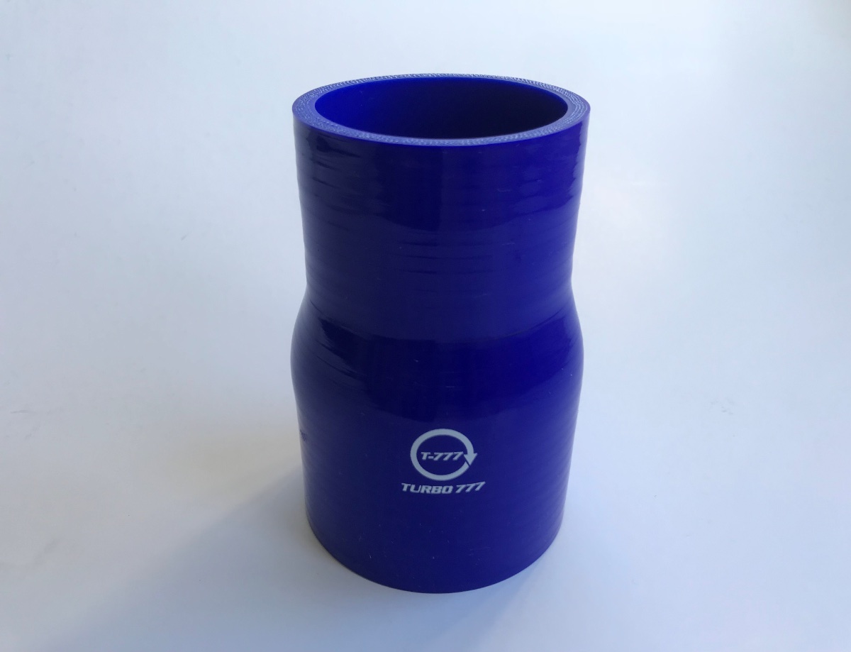

Ex Machina 365 Posted October 28, 2021 Share Posted October 28, 2021 13 hours ago, mattm said: Whats the best way? Boat is a Thompson with a canting prod. What’s the best permanent or temporary solution for sealing the hole somewhat? We have a coastal delivery coming up, in which we may want to use the prod, then just in general? I’ve seen various rubber boots, seem to be either stuck to the hull at the base of the prod, or a rubber boot that stays on the end of the prod. Are either of these suitable for a canting prod, what are they called and who sells them? I haven’t seen the boat yet, so I don’t have photos or specifics. I have heard of silicone rubber reducers that are used for intercooler/turbo induction lines being used for this . they come in a shed load of different sizes and are a bit more durable than neoprene . Boy racer shops are a good source of them so should be plentiful in chch ! Quote Link to post Share on other sites
