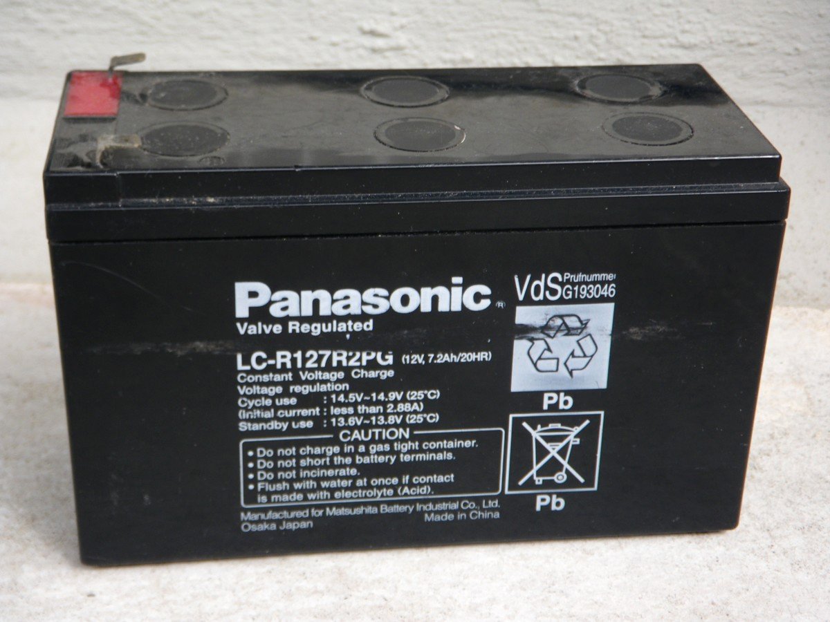

MartinRF 87 Posted May 26, 2025 Share Posted May 26, 2025 On 20/05/2025 at 2:02 AM, waikiore said: Oh simple me, I go sailing to relax, enjoy the environment and not worry, so that ruled out Lithium batts of any type (and the cost) have I suffered-not a whit. My battery, all 7.2 Ah: /Martin 1 Quote Link to post Share on other sites
