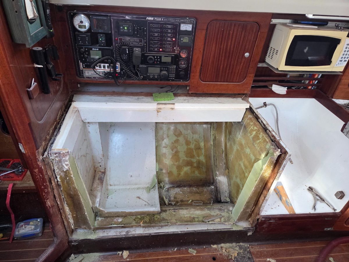

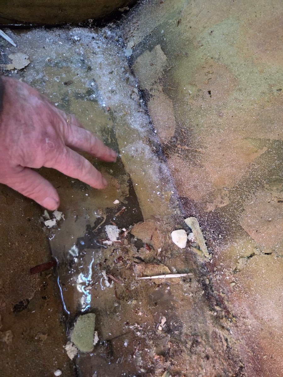

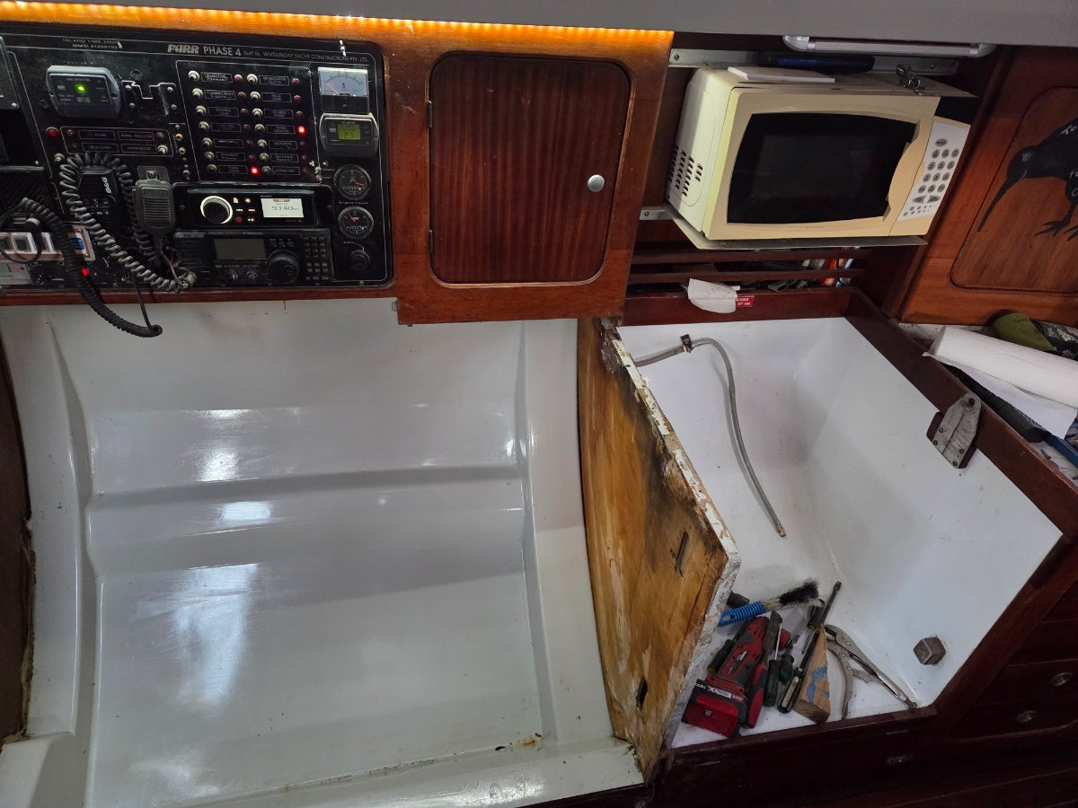

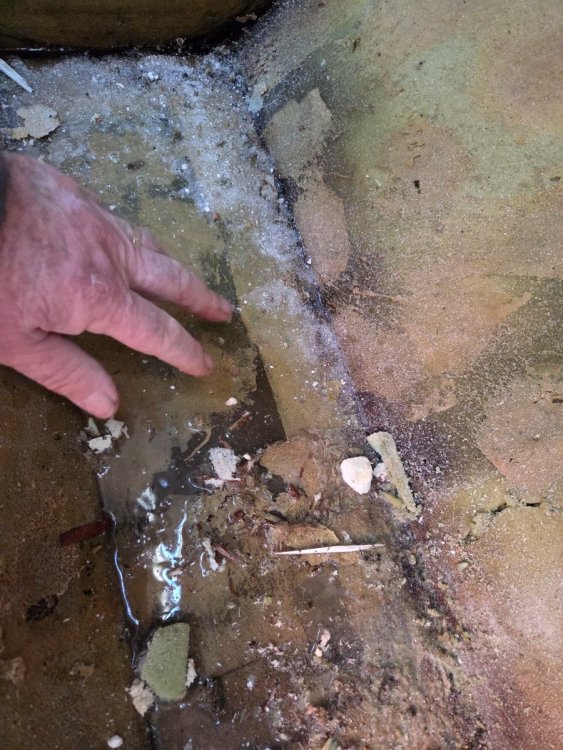

Island Time 1,351 Posted June 7, 2025 Share Posted June 7, 2025 Well, after 38 years, the fridge and freezer in Island Time is due for replacement. They are big (290ltrs), but the insulation is knackered. It now takes a lot of running to keep cold, and has greatly reduced hold over. Due to the time of year, and the lack of work at the moment, I've bitten the bullet. Below you can see removing the cabinet, how wet the insulation was, and how it looks,with the cabinet removed tonight .. 1 Quote Link to post Share on other sites

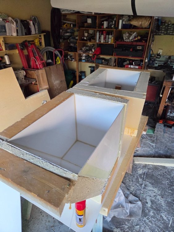

Island Time 1,351 Posted June 18, 2025 Author Share Posted June 18, 2025 So the cabinets are coming along. Next I have to figure out how to do the lids and seals. The old ones were hinged, but only sealed on 3 sides, not along hinged edge. Anyone got any clever ideas about how to make a lid that seals properly and hinges? Maybe I'm over tired, I can't think of a good way right now! And thanks to Tony (ynot on here) for the insulation! 1 Quote Link to post Share on other sites

Frank 232 Posted June 18, 2025 Share Posted June 18, 2025 10 hours ago, Island Time said: So the cabinets are coming along. Next I have to figure out how to do the lids and seals. The old ones were hinged, but only sealed on 3 sides, not along hinged edge. Anyone got any clever ideas about how to make a lid that seals properly and hinges? Maybe I'm over tired, I can't think of a good way right now! And thanks to Tony (ynot on here) for the insulation! Nice work Matt, what is the white liner material ? looks like 6mm thk GRP or something similar ? Quote Link to post Share on other sites
aardvarkash10 1,179 Posted June 18, 2025 Share Posted June 18, 2025 Couple of ideas depending on the total design. Lift and swing hinge that allows the lid to lift 8 to 10mm before swinging up. This allows a seal that is in compression vertically, but not under shear when opening. Second option is a bifold design. This has a shorter shear and added advantage of less vertical height needed when opening. Third is to fillet the lid so the hinge seal sits against the side of the box instead of the top 2 1 Quote Link to post Share on other sites
kaki anau 11 Posted June 20, 2025 Share Posted June 20, 2025 Hi Matt, The solution I came up with when I rebuilt my fridge is I cut a square flange from 1.2mm 430 stainless steel and embedded that in the top of the fridge that receives the lid. I then cut a similar square flange for the lid. I fitted a standard magnetic fridge seal to the flange on the lid. The lid is hinged and seals on all four sides with the magnetic seal. I had the magnetic seal made to fit so there are no joins in the seal: Seal-A-Fridge: 0800 36 77 99 www.sealafridge.co.nz Although the seal holds the lid closed, I retained the original latch so the lid is latched closed (in case of roll-over). Note, the stainless needs to be 430, not 316 as 316 is not magnetic. I learnt this the stupid way Regards Kieran 2 4 Quote Link to post Share on other sites

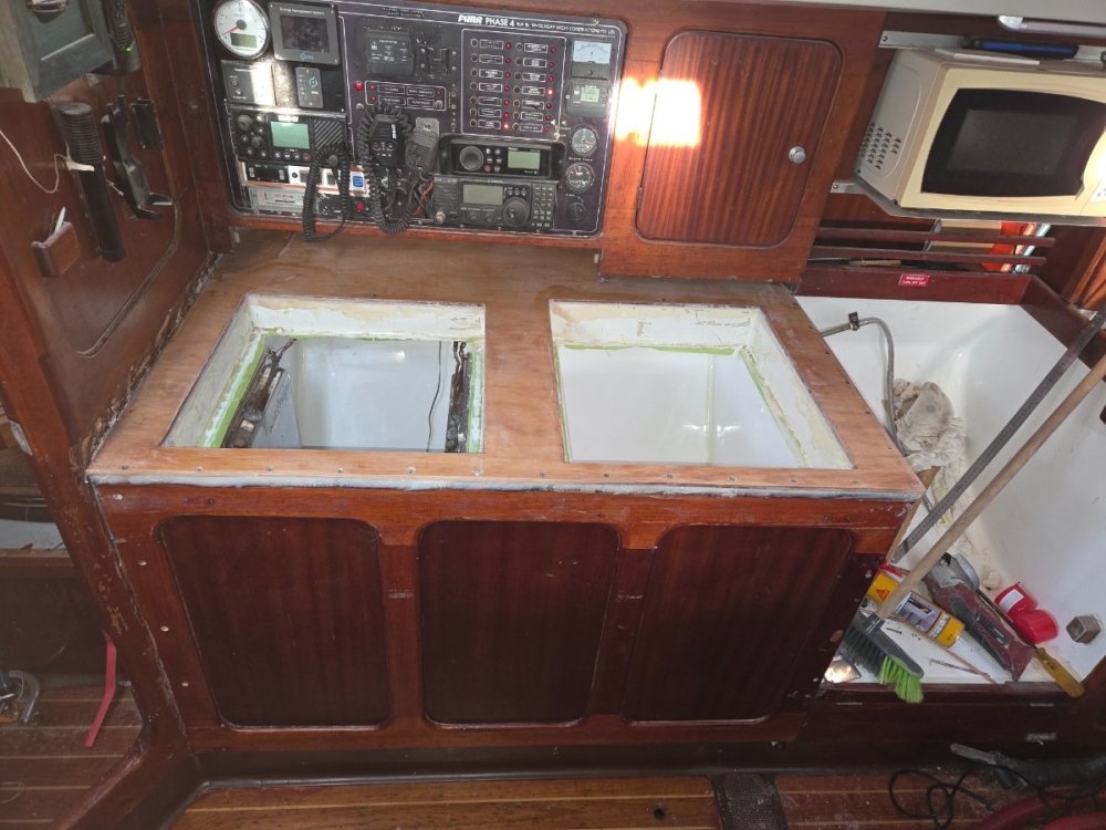

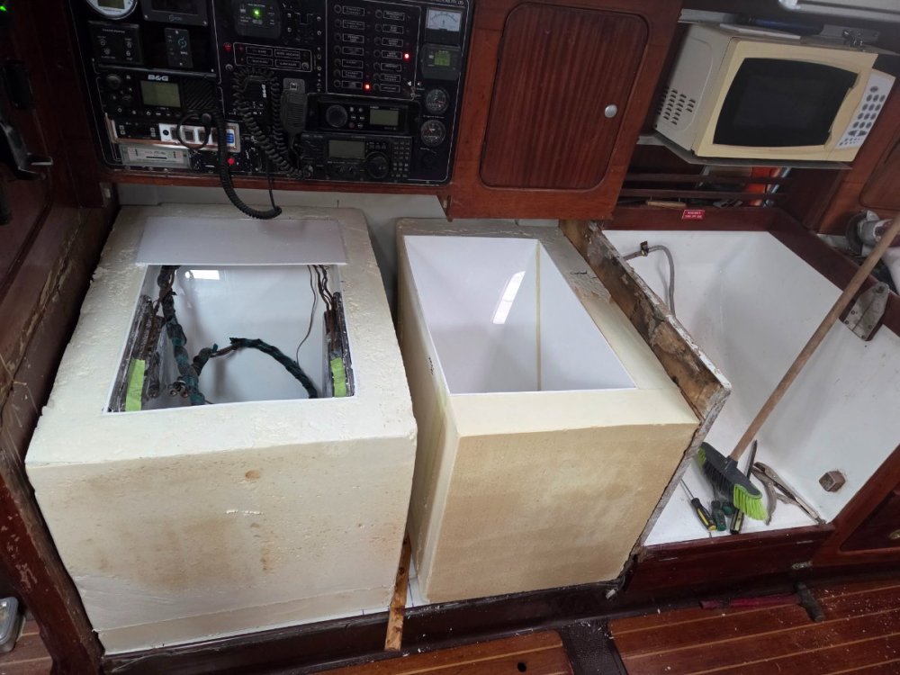

Island Time 1,351 Posted June 24, 2025 Author Share Posted June 24, 2025 On 19/06/2025 at 3:50 AM, Frank said: Nice work Matt, what is the white liner material ? looks like 6mm thk GRP or something similar ? Its 5mm Acrylic. Bit more progress today with a test fit before side on fridge and top on both 1 1 Quote Link to post Share on other sites

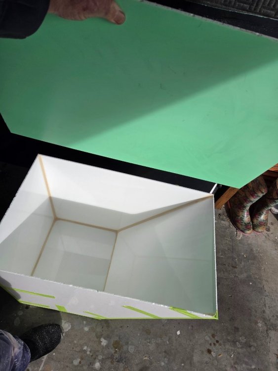

Island Time 1,351 Posted July 4, 2025 Author Share Posted July 4, 2025 Current state... coming along slowly... 1 Quote Link to post Share on other sites
