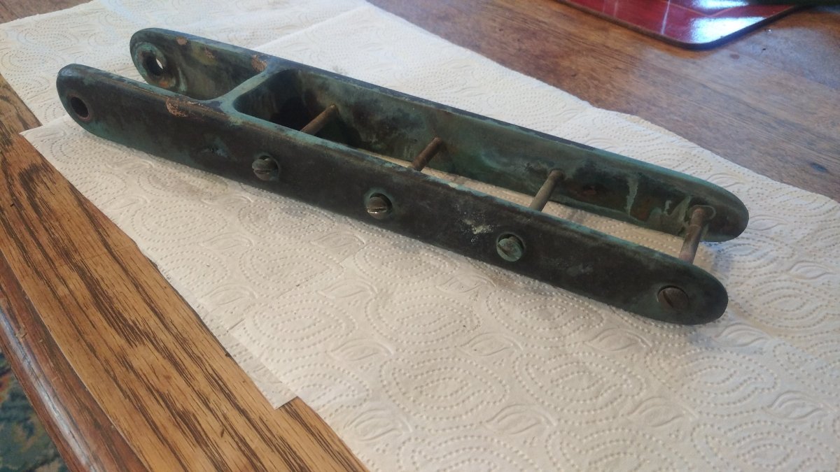

aardvarkash10 1,174 Posted November 3, 2025 Share Posted November 3, 2025 What's the trick? Or do I drop it to the local metal refinishers and let them do the biz? Quote Link to post Share on other sites
CarpeDiem 575 Posted November 3, 2025 Share Posted November 3, 2025 Lemon juice and baking soda into a toothpaste like consistency. Wax on, wax off. Or Brasso if you want to go down the chemical path. Then finish it with a metal lacquer like protectaclear. 1 Quote Link to post Share on other sites
LBD 224 Posted November 3, 2025 Share Posted November 3, 2025 A cloth buffing wheel on a bench grinder would make quick work of it, but brasso and a couple of beers to while away a relaxing arvo on the veranda also works well and is more satisfying. 1 Quote Link to post Share on other sites
aardvarkash10 1,174 Posted November 3, 2025 Author Share Posted November 3, 2025 I've tried brasso, it's not even looking at it.... Might go the acid paste route. Quote Link to post Share on other sites
Psyche 928 Posted November 3, 2025 Share Posted November 3, 2025 Lemon juice does the trick, or citric acid from the supermarket. Leave it overnight 1 Quote Link to post Share on other sites
Black Panther 1,822 Posted November 3, 2025 Share Posted November 3, 2025 Coca cola, overnight soak. You'll never drink that sh*t again but your tiller will have a shiny new seat. 1 Quote Link to post Share on other sites
aardvarkash10 1,174 Posted November 4, 2025 Author Share Posted November 4, 2025 28 minutes ago, Black Panther said: Coca cola, overnight soak. You'll never drink that sh*t again but your tiller will have a shiny new seat. Are you implying that if I drink it, I might get a shiny new seat as well? Quote Link to post Share on other sites
LBD 224 Posted November 4, 2025 Share Posted November 4, 2025 2 hours ago, aardvarkash10 said: Are you implying that if I drink it, I might get a shiny new seat as well? Not sure if it works so well on tin AR______ 1 Quote Link to post Share on other sites
aardvarkash10 1,174 Posted November 4, 2025 Author Share Posted November 4, 2025 Tried with some vinegar tonight. Then I found some dry acid pool pH balance stuff in the cupboard - sodium superphosphate potassium permangler or similar. Gonna play chemist this weekend. Could end up looking like a meth cook. Quote Link to post Share on other sites
