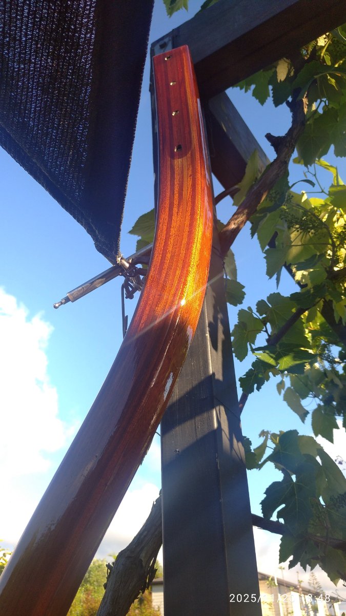

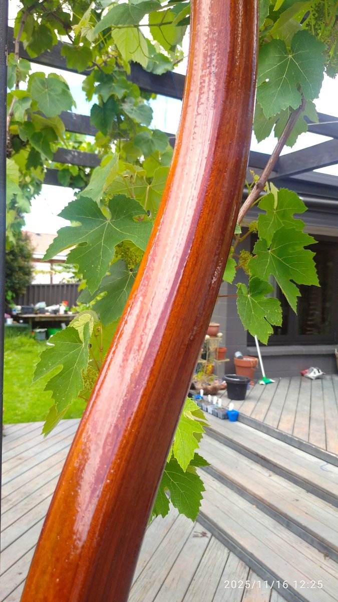

aardvarkash10 1,159 Posted November 18, 2025 Author Share Posted November 18, 2025 Ok, so we stripped the old finish off, sanded to 320 grit, and then pondered, struck with fear of the unknown I eventually mixed some bog-stock, off the shelf norski 4:1 epoxy, about 250ml finished mix. 5 minutes later it was steaming and exothermic like a champion. So I mixed about 80ml finished mix and applied it with a 35mm or there about a roller. And then repeated while the first coat was tacky. 24 hours later it was glossy but very orange peel-ish. Fortunately, it was sanding beautifully so I hit it with a 120 dry then 320 dry then 600 wet. It's now got a beautiful smooth finish and when I tack clothed it the shine comes out nicely. Poly u this weekend. Thanks for the advice everyone. 3 Quote Link to post Share on other sites

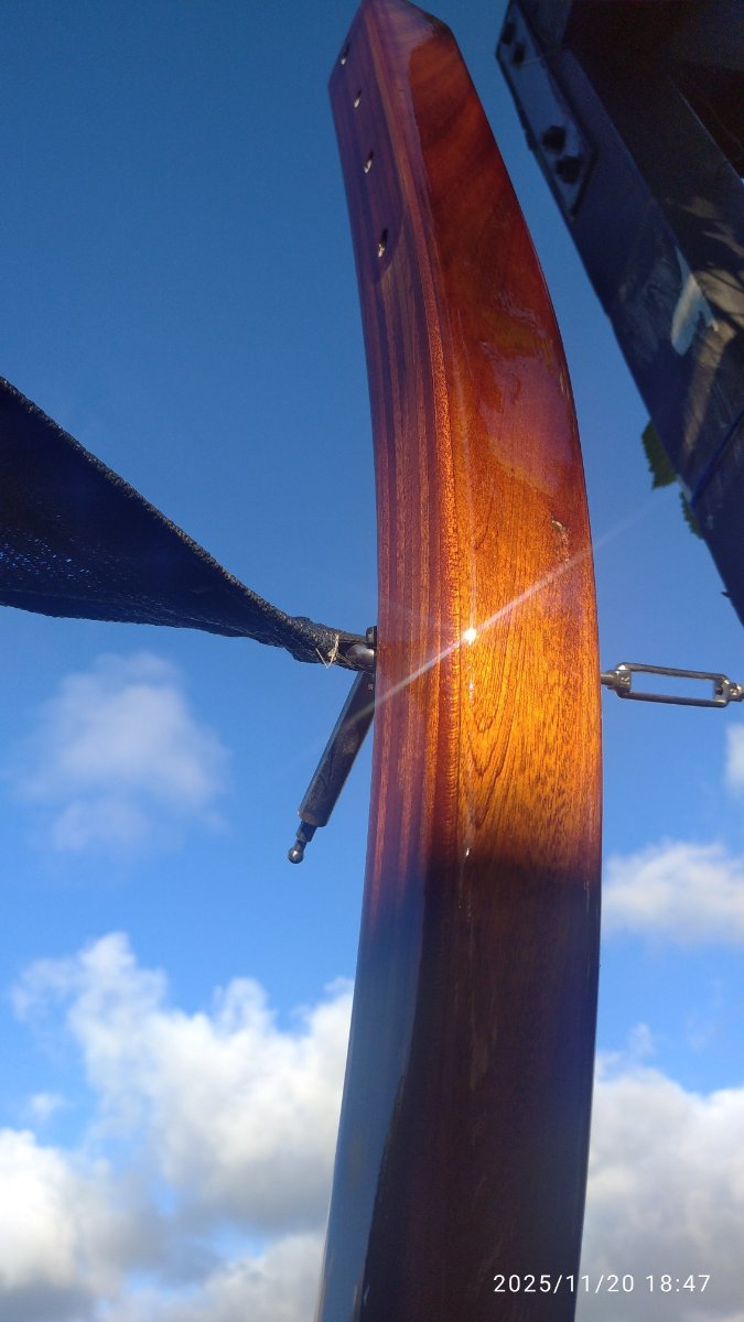

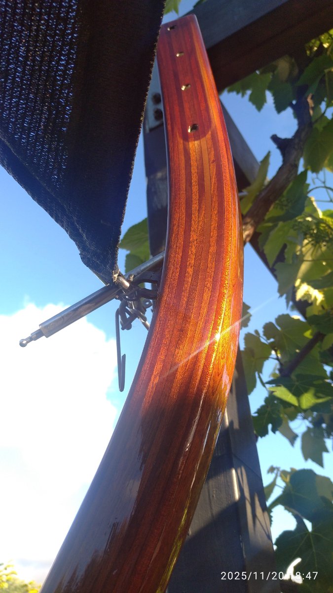

aardvarkash10 1,159 Posted November 20, 2025 Author Share Posted November 20, 2025 FIGJAM 2 Quote Link to post Share on other sites
CarpeDiem 563 Posted November 20, 2025 Share Posted November 20, 2025 Looks good! You could choose a durepox xtreme clear instead of a poly u. I just did my carbon spin pole with it. When I redo the tiller I will swap out the polyu for the durepox now that I am familiar with it. Burnsco have the high performance clear which isn't as good as the xtreme but it's still pretty good. you'll need to get the xtreme from Resene Automotive. It's got rock solid uv protection. 1 Quote Link to post Share on other sites
