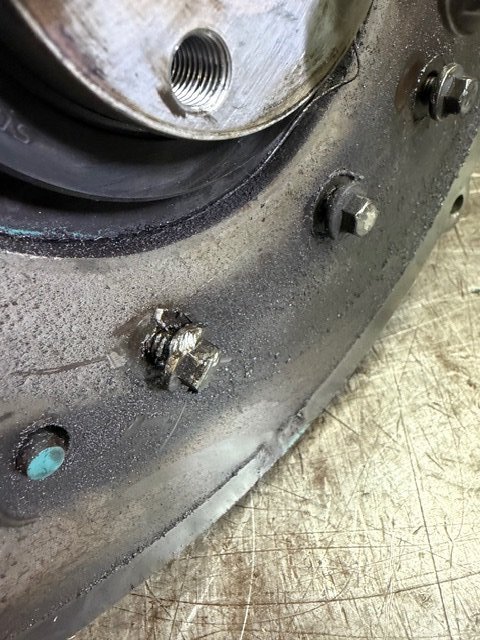

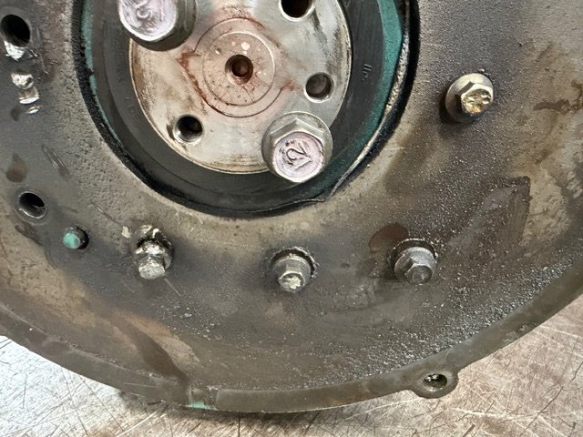

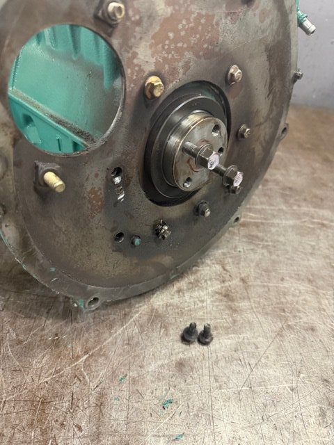

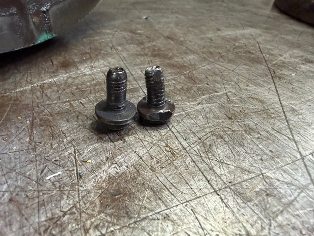

Frank 232 Posted January 23 Author Share Posted January 23 Here are photos of the damage, I think the feedback was a bit ambiguous, it looks like the adapter plate bolts came loose not the flywheel attach bolts which seem fine. I need HEAD GASKET · F/TIMING COVER GASKET · ROCKER GASKET · FRONT & REAR SEAL · REPLACEMENT ADAPTER PLATE BOLTS · WATER PUMP GASKET · SUMP GASKET Might need to buy a full seal kit if possible, the ones online involve a full overhaul kit including pistons and rings ! @ $750 (parts 4 engines) need to do a bit of phoning around on Mon me thinks. Quote Link to post Share on other sites

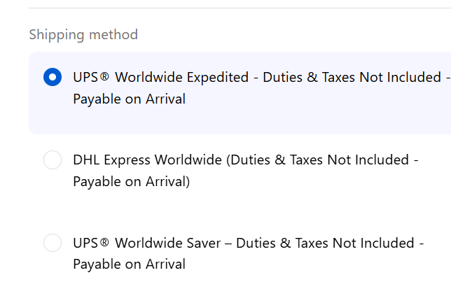

Frank 232 Posted January 23 Author Share Posted January 23 @MCP, thx for suggestion to use Parts4engines , they have the seals I need If anyone has used them, what's the story with shipping as all options say that tax is payable on arrival, do I get a call from Customs saying pay the GST or ....? chrs Quote Link to post Share on other sites
CarpeDiem 575 Posted January 24 Share Posted January 24 9 hours ago, Frank said: @MCP, thx for suggestion to use Parts4engines , they have the seals I need If anyone has used them, what's the story with shipping as all options say that tax is payable on arrival, do I get a call from Customs saying pay the GST or ....? chrs You will need to provide an import number to your agent if it's over a threshold. You can apply for one via the customs website but usually the agent can apply on your behalf - takes about a day for customs to issue you with a number if the agent applies and 5 days if you apply directly. Ups's nz agent will invoice you for the gst. You pay it and they ship it. They charge to store the item in their warehouse so do not delay. 1 Quote Link to post Share on other sites
