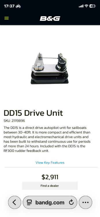

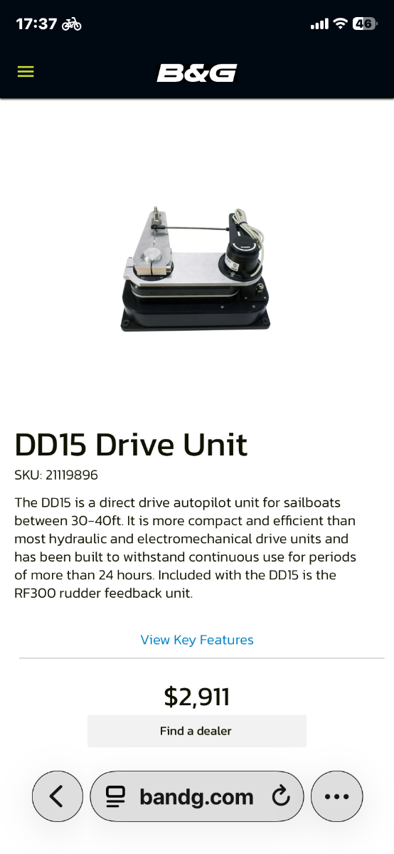

Vivaldi 63 Posted January 12 Share Posted January 12 does anyone have one of these installed in their boat? I’ve currently got a B&G hydraulic ram which makes the helm feel like you’re steering an old wooden scow. Without the ram on its fingertip light which is nice. The DD15 supposedly offers no resistance when it’s in standby mode which would be nice so wanting to know if anyone has experience with them. Quote Link to post Share on other sites
CarpeDiem 575 Posted January 12 Share Posted January 12 This is the same as the Jefa DD1. I have one I am in the process of installing. It's not zero resistance with the clutch disengaged. You're still turning planetary gears which are in a sea of grease but you're not also turning the motor. Quote Link to post Share on other sites

Island Time 1,350 Posted January 17 Share Posted January 17 On 14/01/2026 at 5:07 PM, Vivaldi said: @Island Time - Matt, do you stock these? Not stock, about 5 days from order. Commonly installed on hanse boats and others. Not as reliable as the rams. Normally seized solenoids and internal water ingress issues. It's usually not a big issue to put in a removable end on a ram, held by an r clip... Quote Link to post Share on other sites
