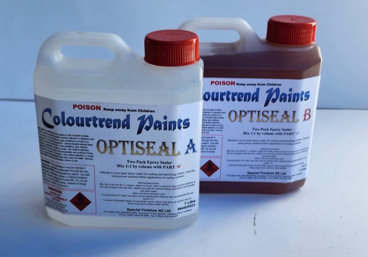

Priscilla II 504 Posted May 24 Share Posted May 24 I have been using this for years does what it says. https://www.trademe.co.nz/a/motors/boats-marine/parts-accessories/other/listing/5947961191 Quote Link to post Share on other sites

Frank 236 Posted May 28 Share Posted May 28 On 25/05/2026 at 7:47 AM, Priscilla II said: I have been using this for years does what it says. https://www.trademe.co.nz/a/motors/boats-marine/parts-accessories/other/listing/5947961191 I checked with these guys its epoxy and a thinner no biocides. Quote Link to post Share on other sites

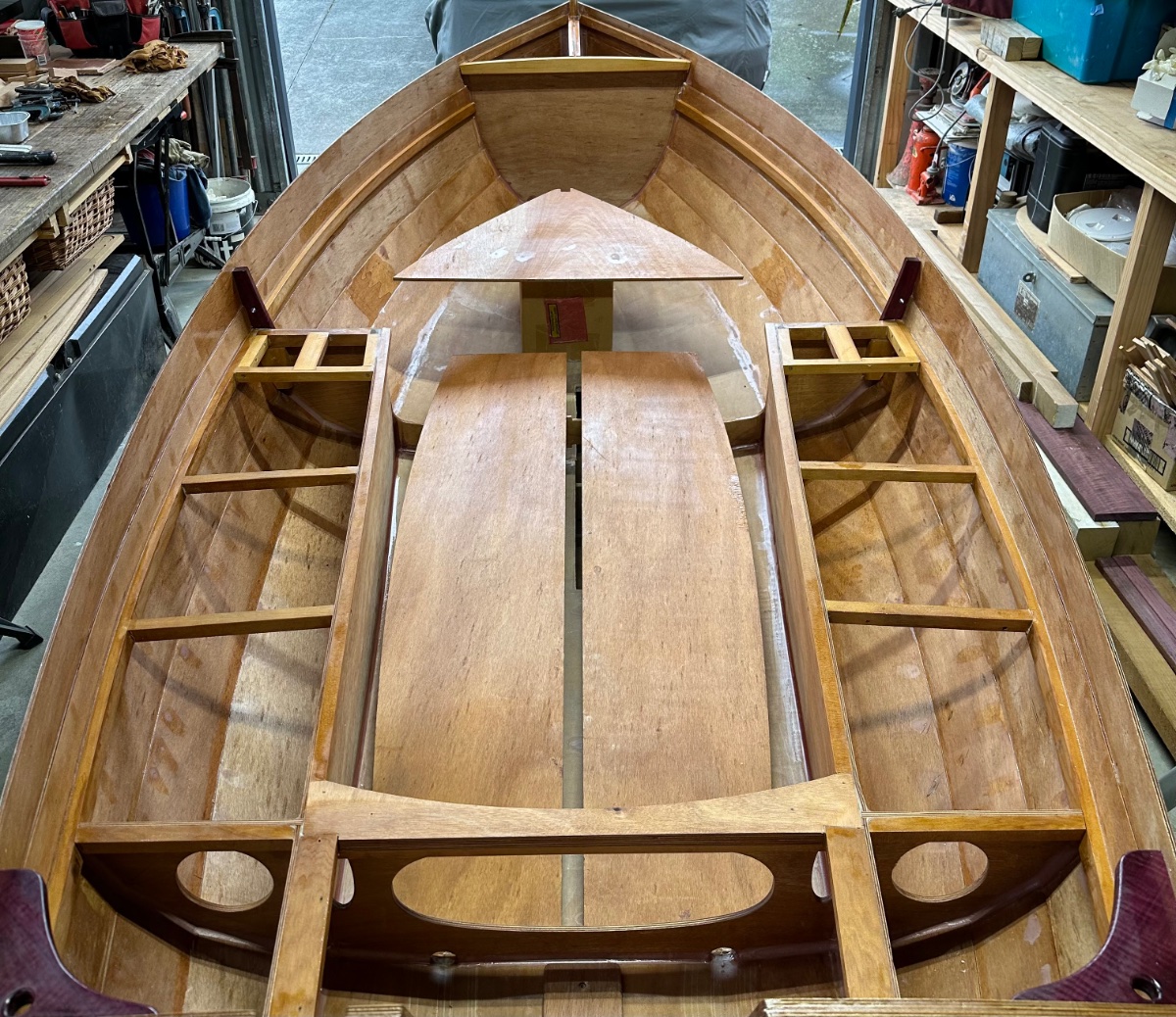

Frank 236 Posted June 1 Share Posted June 1 Agree, I'm using it on repairs to my weatherboard house , buts its my el-cheapo DIY thinned resin version :-), nice Dinghy BTW Quote Link to post Share on other sites
