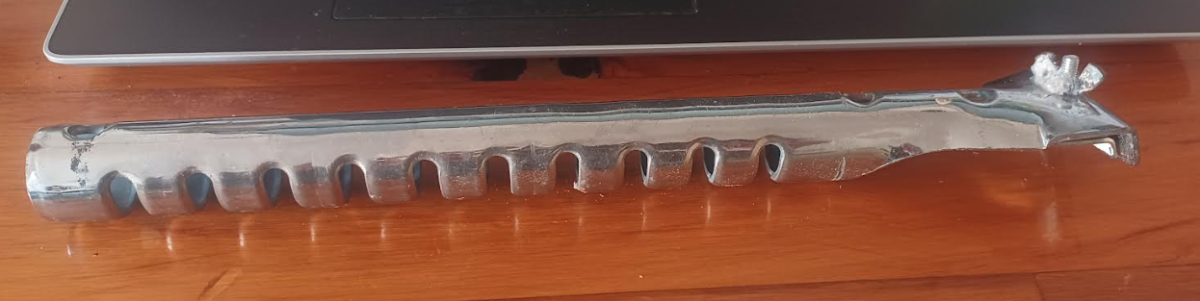

Frank 232 Posted June 23 Share Posted June 23 If you can get one of these long handled versions or otherwise stick a chopped off broom handle up the shank of a short one . There is supposed to be a knob on the top near the blade but someone has removed it grrrr. Quote Link to post Share on other sites

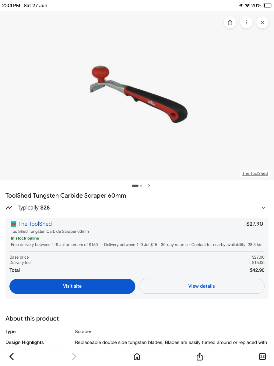

whitepointer 36 Posted June 27 Share Posted June 27 I scraped back Lidgard 35 Whitepointer 3 years ago using hand tungsten scraper from the tool shed, two handed scraper, worked well but seriously hard yakka for about 5 days, then had to follow up with filling the scrap marks and orbital sanding 2 Quote Link to post Share on other sites
