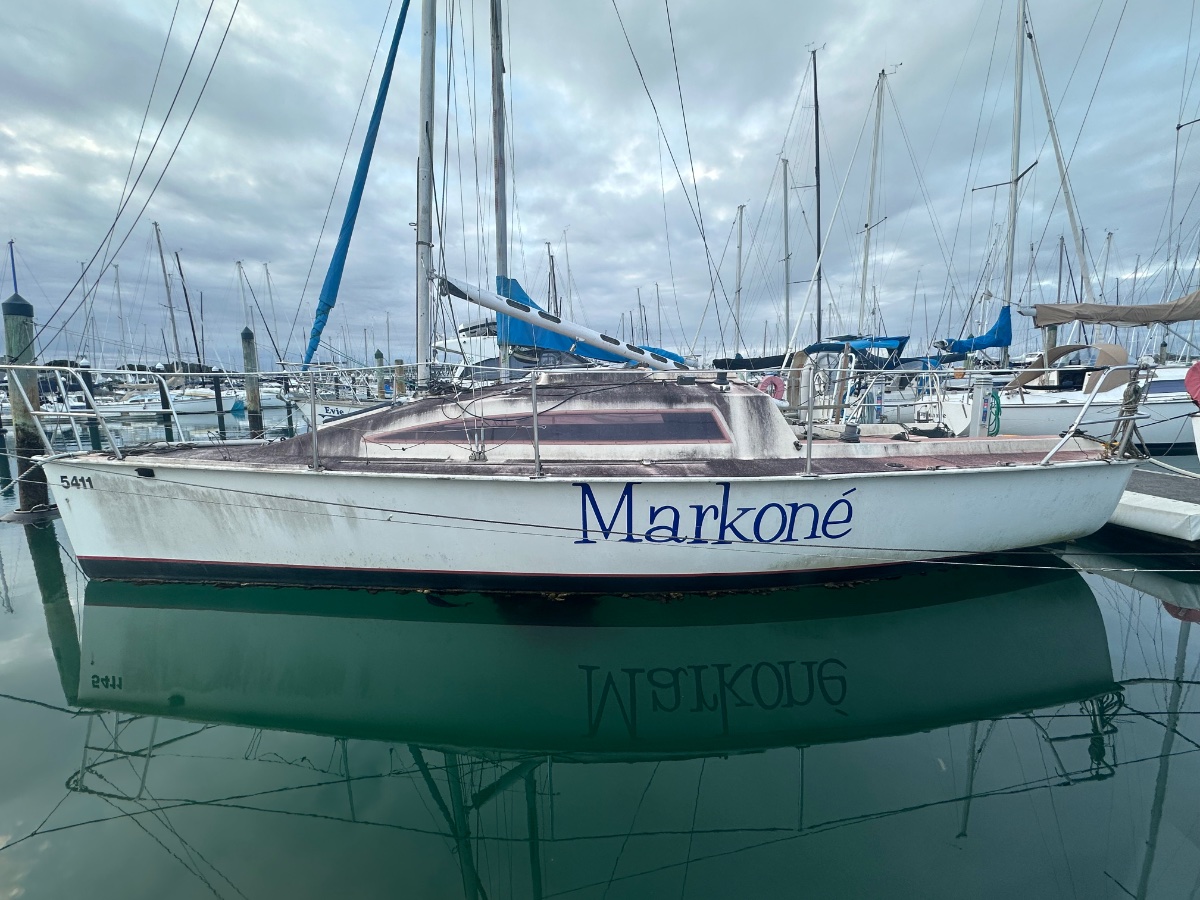

Priscilla II 493 Posted July 6 Share Posted July 6 Talking of SR26’s Markone’ recently became a total loss under the harbour bridge after languishing on the marina for many many moons. Quote Link to post Share on other sites

LE Bb 41 Posted July 9 Share Posted July 9 What do actually need ? Priscilla II what happened ? I met the new custodian and his partner, they'ed done a huge clean up job on Markone Quote Link to post Share on other sites
