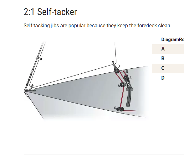

Psyche 973 Posted August 10 Share Posted August 10 Had a self tacker on a boat a long time ago, no real advantage. Probably could work ok on a cutter setup to save grinding 2 sheets but on a sloop you're limited to small jibs and unless you have a big boat small jibs are so easy to trim. Ross 930's had them but all gone now at least on the ones I see in the marina. One reason may be that what you gain in quick tacks you lose in sheeting position and headsail choice? Plenty of guides out there; https://www.harken.com/en/support/selection-tools/system-diagrams/self-tacking-jib-and-staysail-systems/?srsltid=AfmBOooyI1OrCyAGrKtMSOSnJxQN0BFuRdhDek8FZzuw98sUu-l91iUT 2 Quote Link to post Share on other sites

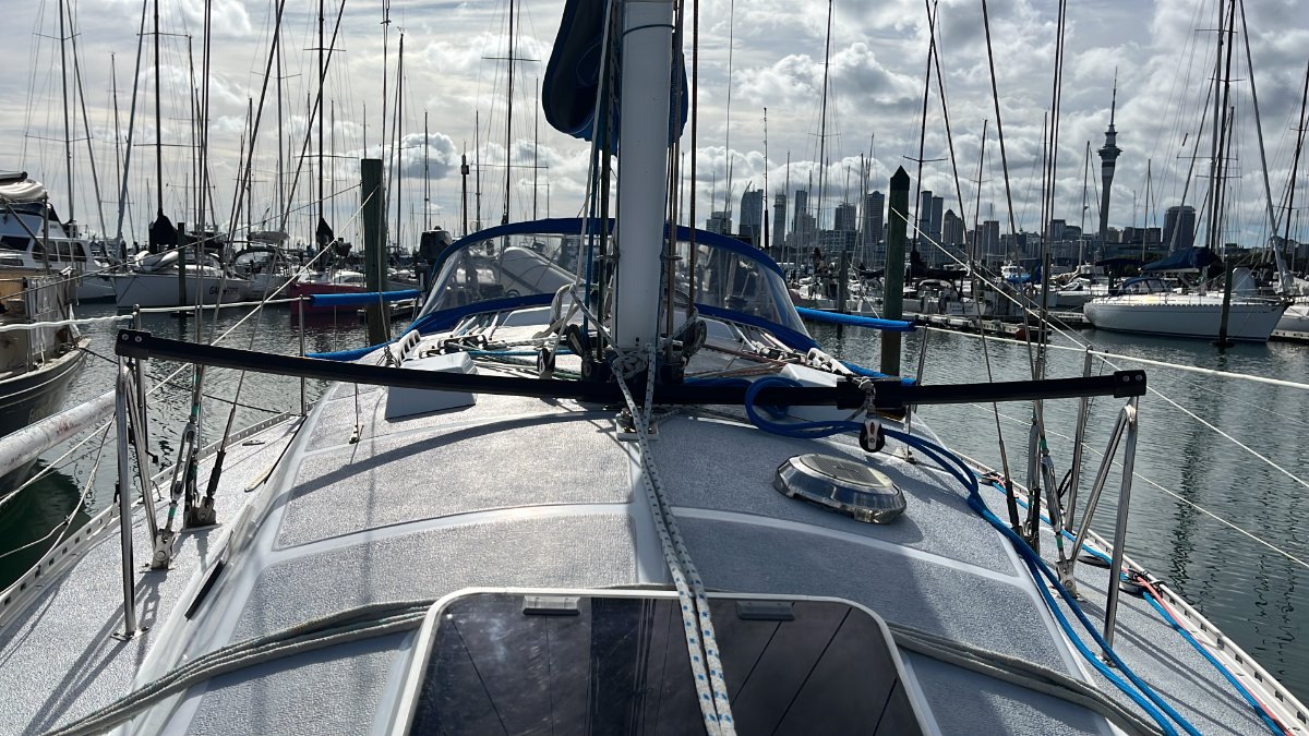

LBD 233 Posted August 11 Author Share Posted August 11 10 hours ago, Psyche said: The arrangement Phyche posted is the arrangment I am looking at for the staysail on my cutter, except a straight track. Track will be on the cabin top and not be trip hazard. 1.8m long in front of the mast. We have had the sail maker down and we have a plan. I will need a new hanked on stay sail cut to suit. (KISS thanks Frank) We will set the sail with optimum design twist in a position that allows us to raise or lower the luff 6 inches thereby adjusting the twist. Why? you ask... less ropes to manage when tacking and it will free up one of the winches in the cockpit. The main sheet is on top of the dodger and is a pain without a winch, so I will then take the main sheet fwd to a block at the base of the mast then back to the no longer required staysail winch. The mainsheet will then be more organised to one side of the cockpit instead of hanging down in the middle of the cockpit. And I will lose the main sheet cam cleat which can be a pain to release in a hurry when tight. And we will lose the two staysail tracks on either side deck that are trip hazards and toe biters. Quote Link to post Share on other sites

MartinRF 87 Posted August 25 Share Posted August 25 Self tacking jib with straight track and one sheet + barber haul. I hope the basic set-up can be gleaned from this non-action video: More action here: The sheet can be operated from either cockpit. Advantage of straight track: Simple installation on cross beam and low tripping risk. Disadvantage of straight track: The car needs some help after each tack/jibe. Once in place it stays in place thanks to sheet line friction. /Martin PS The boat turned 40 this season. 3 Quote Link to post Share on other sites

Magic Bus 3 Posted August 26 Share Posted August 26 We have a self tacker on our Ross 35, we removed it for many years but 5 or 6 years ago i shortened it so i could walk around the outside of it and put it back on. It is a single 2:1 sheet running forward to a single block with a becket and then back to the port primary with a outboard/ inboard adjuster for the track run back to the cockpit (i need to find a better system for this). It is amazing when short handed sailing in anything over 15 knots. I broke the original track in a bit of blow a while back but got a replacement harken on from fosters - the track needs to pre bent at the factory so spending a bit of time working out the profile for this is really important (so the sheet has constant tension as you tack). Only issue is that the sheet can snag on the foward hatch through tacks but i have found a couple of well placed bungies running of the hatch has solved that - im thinking a grab handle or something similar aft of the hatch may work as well. 1 2 Quote Link to post Share on other sites
