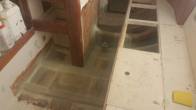

funlovincriminal 218 Posted October 19, 2015 Share Posted October 19, 2015 Ok, plenty of non boating stuff going on over the last couple of weekends but managed to squeeze a bit more alone time in to tick another couple of items off the list. Bathurst weekend was internal strengthening time, I wasn't entirely happy with the lack of structure in the stbd side of the keel case so opted to build a kitset ring frame to tie it to the floors, stbd chainplate and bunk fronts. Using CAD (Cardboard Aided Design) I made templates up and then traced them onto 19mm ply. I laminated three bits of this together to make a 57mm thick frame which I then glued, coved, taped and glassed into place. Plenty more tape and double bias cloth went into the existing keel floors, keel case and bunk fronts as well. 200mm was as high as I could practically go whilst still allowing my smallest crew member to step over it... Not sure what difference it will make to performance but I feel more confident in it's strength now that's for sure. I managed to sneak out and see the Solo IQ boys on the Sunday morning and have a bit of a look at the internal structure on Cool Change too which made me feel better about the direction I was taking. I watched the first and last hours of Bathurst although my usually pedantic peel ply application suffered in my haste to clock off! Quote Link to post Share on other sites

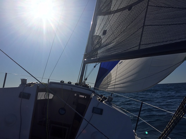

dkd 3 Posted October 20, 2015 Share Posted October 20, 2015 At long last managed to get out and go for first sail in her since she left NZ and being finished what became extended overhaul No longer is she "trainsmash" ..... new name, new water to play in and i am happy camper and then had to go back to workearly and my "other boat" 2 Quote Link to post Share on other sites
funlovincriminal 218 Posted October 20, 2015 Share Posted October 20, 2015 Great to see the old girl back in her element! - Well done on the refit. Quote Link to post Share on other sites

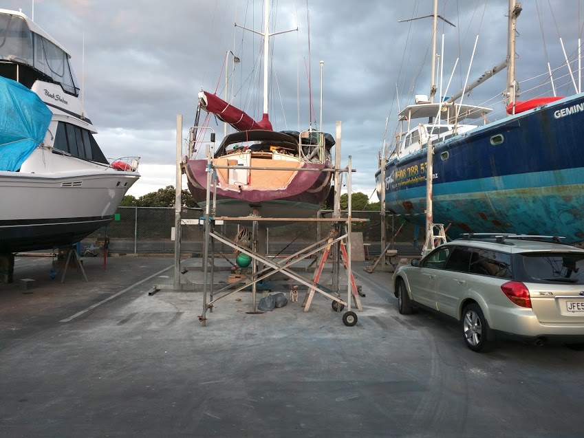

Battleship 100 Posted October 21, 2015 Share Posted October 21, 2015 Transom Mod, 1 Quote Link to post Share on other sites
erice 732 Posted October 21, 2015 Share Posted October 21, 2015 quite a transformation looks good Quote Link to post Share on other sites
Variant 2 Posted October 21, 2015 Share Posted October 21, 2015 Nice! Quote Link to post Share on other sites
Island Time 1,350 Posted October 21, 2015 Share Posted October 21, 2015 Looks great. You'll really like it, it makes the boat way more functional - well worth the time effort and expense IMO Quote Link to post Share on other sites
John B 119 Posted October 21, 2015 Share Posted October 21, 2015 Really nice Willow, great job . I like the little curved duckboar extension. I've lost track though , what design is she, I was thinking Lidgard looking at the transom on the hardstand photo ? But then I see the flair above the waterline in the on water shot and I start thinking Davidson........ The other job we did before going sailing was fit the radar up the mast. Brackets on on fri afternoon and the unit and wiring on sat morning. It went !. The boat did not blow up. Our brains did not get fried. However I can reliably tell you that a lopper style two handed pop riveter is not the correct tool for this particular job. Not when you want one hand to carve out fingernail marks in the mast paint, and the other to do the popping. Quote Link to post Share on other sites
ex Elly 277 Posted October 22, 2015 Share Posted October 22, 2015 @JohnB, Berenice is designed by Mitchinson, a Tauranga designer. Touchdown is another of his. Quote Link to post Share on other sites
