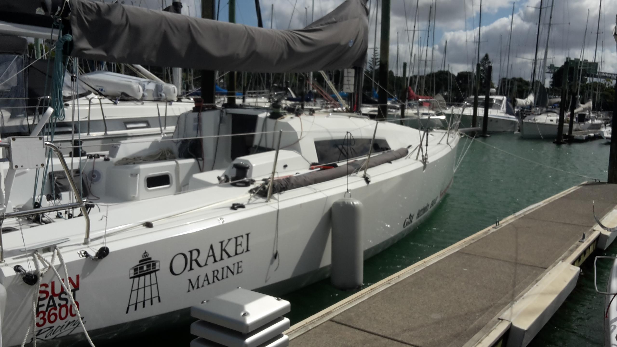

B00B00 343 Posted October 17, 2016 Share Posted October 17, 2016 Made up a new much longer carbon prod for the Sun Fast. Prod is around 15mm think carbon with a foam core and a full length horrozontal bulkhead, we got this engineered by a mate of ours and stuck to his layup plan. Didnt vacuum bag it as we dont have technoligy like that but Dave Faulkner who made up the original blank/mold shape for us vacumed bagged that (huge thanks to Dave for his help witht he project). We had to extend the hull flange attachment an extra 150mm past the hull resess to get enough shear strength and go from 3 to 5 bolts. Decided to make up some low stretch bobstays as the 2 attachment points creates a headache where dynex is to variable in the its length (shrinks when not loaded and creeps when loaded) so was worried about point loading the prod on the unused bobstay. These are wound 4mm vectran core (8 laps @ 570kg break each) with a dyneema chafe cover over the top and onto ferruls. The bottom has both spliced onto 1 ferrul with the through hull attachment around the radius. Came out pretty tidy actually. Didnt have time to fair and paint it so its currently just a peel ply finish but will be fine for now and will have a go at finishing it off after coastal classic. Also removed the furler and changed to a rod forestay with hanks. big night in the loft changing all the headsails over to hanks. A few bigger sails to fit tomorrow and we should be good to go. Been a big few weeks. 1 Quote Link to post Share on other sites
