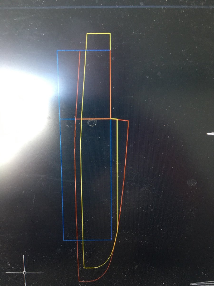

Deep Purple 530 Posted April 24, 2021 Share Posted April 24, 2021 2 hours ago, 44forty said: First step of the new rudder done .... aircraft wing style of construction . carbon foam sandwhich panel laid up in the garage then sent to the CNC dude . next step is to wrap it in some funky sh*t then tip in some 2 part expanding foam . The foam will be sanded back to the ribs and then then it will get skinned carbon . design and construction is being done by my mate Scott who is handy with a computer and carbon . Check his Ross 490 rebuild here on creworg and in boating Nz The rudder will be hanging off a second generation E780 that we are bringing into this century ....next project will be a prod ...possibly a hybrid fixed job with a retractable prod inside it that stays outboard so cabin doesn’t have a bit of carbon right through it How does the top work? How much balance forward? Quote Link to post Share on other sites
Ex Machina 390 Posted April 24, 2021 Share Posted April 24, 2021 10 hours ago, Deep Purple said: How does the top work? How much balance forward? The top is where it gets interesting . It’s going to have an 18ft skiff style box where it slots in from aft rather than a drop-in style box . Rudder will have a socket on top to plug a carbon tube tiller into , we have that system on the Shaw and love it . The idea is to be able to take rudder and tiller off at anchor or at the dock to free up cockpit space and prevent any expensive accidents after a few beersies . I couldn’t tell you the percentage of balance forward ...the pic shows the current rudder in blue , the Shaw 750 rudder in yellow and the new rudder in red which is way more forward balanced than the old Rutter . Weight wise there should be a massive difference the current rudder would be at least 15+ kgs and the box is about the same so it’s like having an extra outboard on the transom ! Quote Link to post Share on other sites

Deep Purple 530 Posted April 27, 2021 Share Posted April 27, 2021 On 25/04/2021 at 8:22 AM, 44forty said: The top is where it gets interesting . It’s going to have an 18ft skiff style box where it slots in from aft rather than a drop-in style box . Rudder will have a socket on top to plug a carbon tube tiller into , we have that system on the Shaw and love it . The idea is to be able to take rudder and tiller off at anchor or at the dock to free up cockpit space and prevent any expensive accidents after a few beersies . I couldn’t tell you the percentage of balance forward ...the pic shows the current rudder in blue , the Shaw 750 rudder in yellow and the new rudder in red which is way more forward balanced than the old Rutter . Weight wise there should be a massive difference the current rudder would be at least 15+ kgs and the box is about the same so it’s like having an extra outboard on the transom ! Our rudder. No balance at all, neutral helm all the time. Never lets go. It's a work of art. Quote Link to post Share on other sites
Fish 0 Posted April 27, 2021 Share Posted April 27, 2021 59 minutes ago, Deep Purple said: Our rudder. No balance at all, neutral helm all the time. Never lets go. It's a work of art. That looks more like a carving knife than a rudder. You could get it out at Christmas to carve the ham... 1 Quote Link to post Share on other sites
