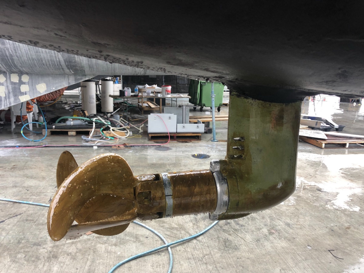

straycat 7 Posted October 30, 2021 Share Posted October 30, 2021 FYI we are trying a propspeed substitute called propeller coat from Japan. Sourced it from paint traders for ok price. Seemed to be easy enough to apply adhering to time between coats, but Will know in 12 months time if it held out. Quote Link to post Share on other sites

straycat 7 Posted October 31, 2021 Author Share Posted October 31, 2021 Yeah 2 coats of primer is needed. It looks to be Japanese version of propspeed, identical I think. https://propellercoat.co.nz/propeller-coat-product.php Instructions are same as for propspeed. Expose the metal and clean it off any grease and dust, apply 2 coats of 2 pot primer, 3 minutes apart. Let it dry and apply top coat which looks like silicone. The kit comes with every item needed for the job, 250 ml did 2 x 3 blade volvo propellers as in picture. Quote Link to post Share on other sites
