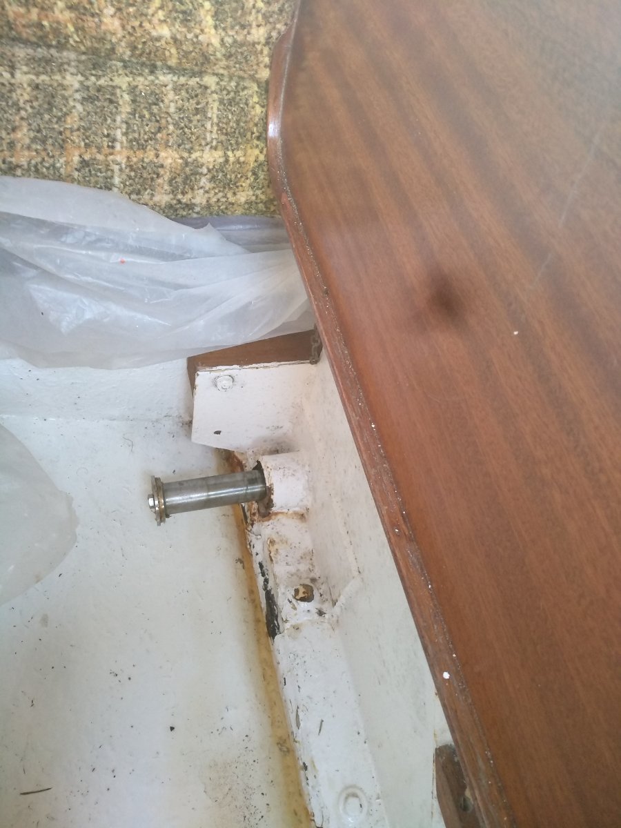

Hi, the centreboard pin has pulled out from one half of the casing on my Noelex 22 so I'm going to reinstall and secure. I was wondering if I should grease the pin perhaps with some marine grease. I'm not sure what seals are in place in the centreboard casing so thought I would check. Is there anything else I should do while I'm at it?
Cheers

Yes I used some timber, chains and a car jack to build a crane on the centreboard housing so I could manoeuvre the plate and realign the holes to put the pub back through. Took a few hours on the anchor with the boat wobbling about and my head down but got it done. She's on the trailer now so much easier.
