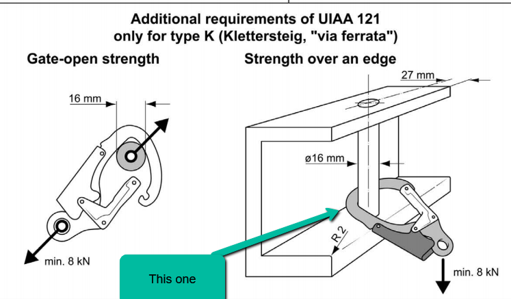

2flit 52 Posted July 20, 2020 Share Posted July 20, 2020 16 hours ago, Knot Me... maybe said: "I would also suggest using some caution with Practical Sailor tests, make sure you suss the methodology very well and the products used in the test." PA used this methodology: Crossloaded over an edge (UIAA 121 type K) https://mproprovider.files.wordpress.com/2008/07/uiaa121_connectors01-2004.pdf (see detail below) "'I'm in with IT, I also don't think the 2 clips photoed side by side are the real deal SpinlocksI." Agreed and I appologize; the picture I posted from the UK governments MAIB report is not the Spinlock clip, the MAIB seem to have made an error in choosing this picture (not PS) HOWEVER>>> See picture of actual clip from the incident aboard the clipper ship. This image is from Robin Knox-Johnson) This clip was tested by PA and had the worst results of the bunch. I think this is significant and can't be discounted. Then; Look over the UIAA procedure tests carried out on the Spinlock and it is clear that this clip is the worst of the entire group tested. (Spinlock dealers touts this clip as being 50% lighter than the competition as a virtue) And finally; Here is a link to the full report on the incident aboard the Around The World Clipper Ship: https://assets.publishing.service.gov.uk/media/5d079e0240f0b609cab64d40/2019-7-CV30.pdf This report takes allot of time to read but is rather illuminating on a range of issues that lead up to Simon's death. Simon was a watch leader, coxswain, and sail repairman aboard ship and he had formerly circumnavigated. There is allot to learn from the full report but - as these reports go - it's a long read. Quote Link to post Share on other sites

mattm 106 Posted July 21, 2020 Share Posted July 21, 2020 Those test results are grim for Spinlock. Kong has a bigger opening and bearing surface and is thicker, between 1.65 to 10 x stronger, yet still lighter, rated to more standards, cheaper and easier to use 😮 Quote Link to post Share on other sites
