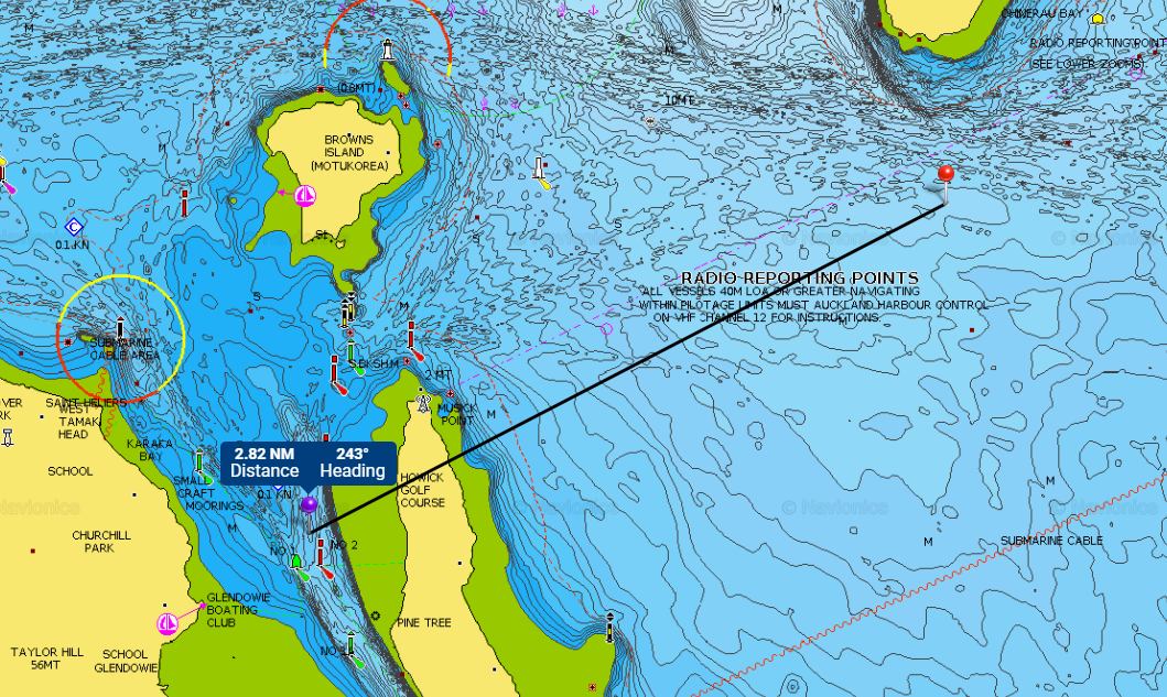

bigal.nz 62 Posted August 20, 2022 Share Posted August 20, 2022 What sort of typical range should I expect from the VHF/AIS. I get there are some variables in this, but today for example I was only intermittently picking up the ferry on AIS when they were 2.8NM away with some terrain in the way.... see picture. AIS and VHF share an antenna with the appropriate splitter. (XB8000 and a Standard Horizon VHF - Furuno antenna (looks old)) Quote Link to post Share on other sites
