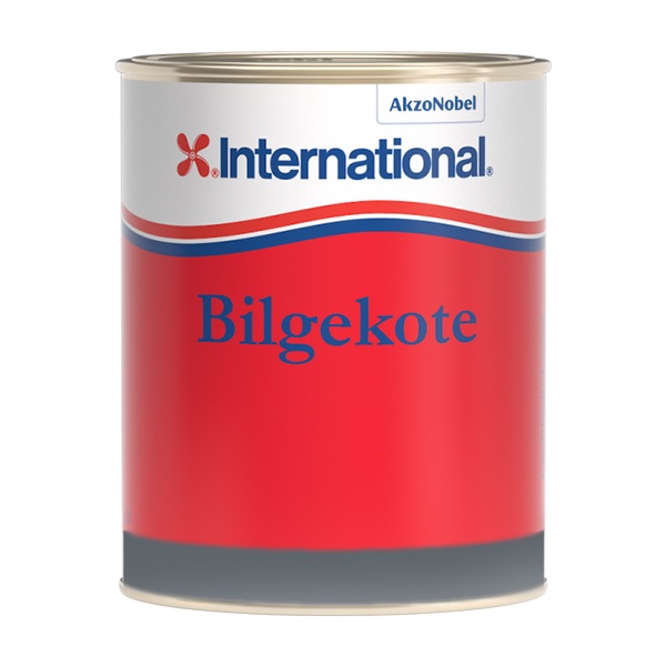

Priscilla II 493 Posted January 23, 2025 Share Posted January 23, 2025 Quote Link to post Share on other sites
