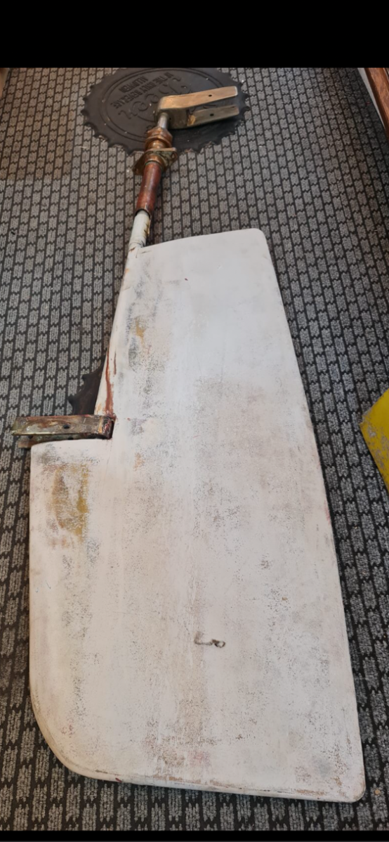

O_Smiladon 4 Posted April 17, 2021 Author Share Posted April 17, 2021 This was on trade me. I could just use this ??? And utilise the bits from this. Battle 1/2 won I reckon Quote Link to post Share on other sites
harrytom 698 Posted April 17, 2021 Share Posted April 17, 2021 imo be worth it,any problems I might be able help you. Quote Link to post Share on other sites
O_Smiladon 4 Posted April 17, 2021 Author Share Posted April 17, 2021 20 minutes ago, harrytom said: imo be worth it,any problems I might be able help you. Yeah I reckon. I will contact the People who had it listed. And thank you so much for your offer of help. That’s Awesome. mate cheers Steve 1 Quote Link to post Share on other sites
O_Smiladon 4 Posted April 19, 2021 Author Share Posted April 19, 2021 Hey Guys, I am off tomorrow to grab this to see if I can make it work, For when Soulmate comes out of the water. Harrytom has very kindly offered his help which will be gratefully accepted when the time comes. But what have here I have to eventually make it look like that first picture. Unless someone has a Cav 26 that they are wrecking haha Thanks for the comments and I am learning heaps guys cheers Steve Quote Link to post Share on other sites
