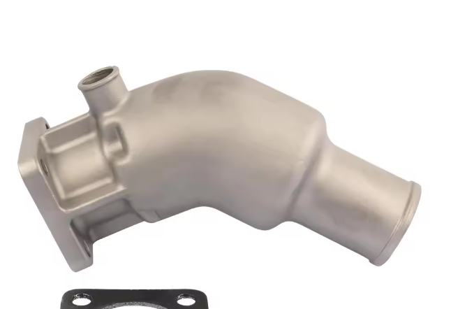

Frank 225 Posted November 21, 2025 Share Posted November 21, 2025 I have a Volvo D1-20 with less than 1000 hrs, Im prepping for the day the cast iron exhaust elbow needs replacing because I,ve noticed it's already festering nicely on the inside of the stub wall. I have seen these reverse engineered cast SS replacements on Aliexpress , does anyone have experience with these ? I know they will not last forever due to crevice corrosion but I suspect it will still outlast cast iron and anyhow its a 1/4 of the OEM price. Quote Link to post Share on other sites
Psyche 923 Posted November 21, 2025 Share Posted November 21, 2025 Beautiful casting, if they have made the effort its probably going to be fine Quote Link to post Share on other sites
Frank 225 Posted November 21, 2025 Share Posted November 21, 2025 5 hours ago, Psyche said: Beautiful casting, if they have made the effort its probably going to be fine I was thinking along the same lines, it look almost like its die cast, I'm not sure how else you could get a cast finish that smooth. Quote Link to post Share on other sites
