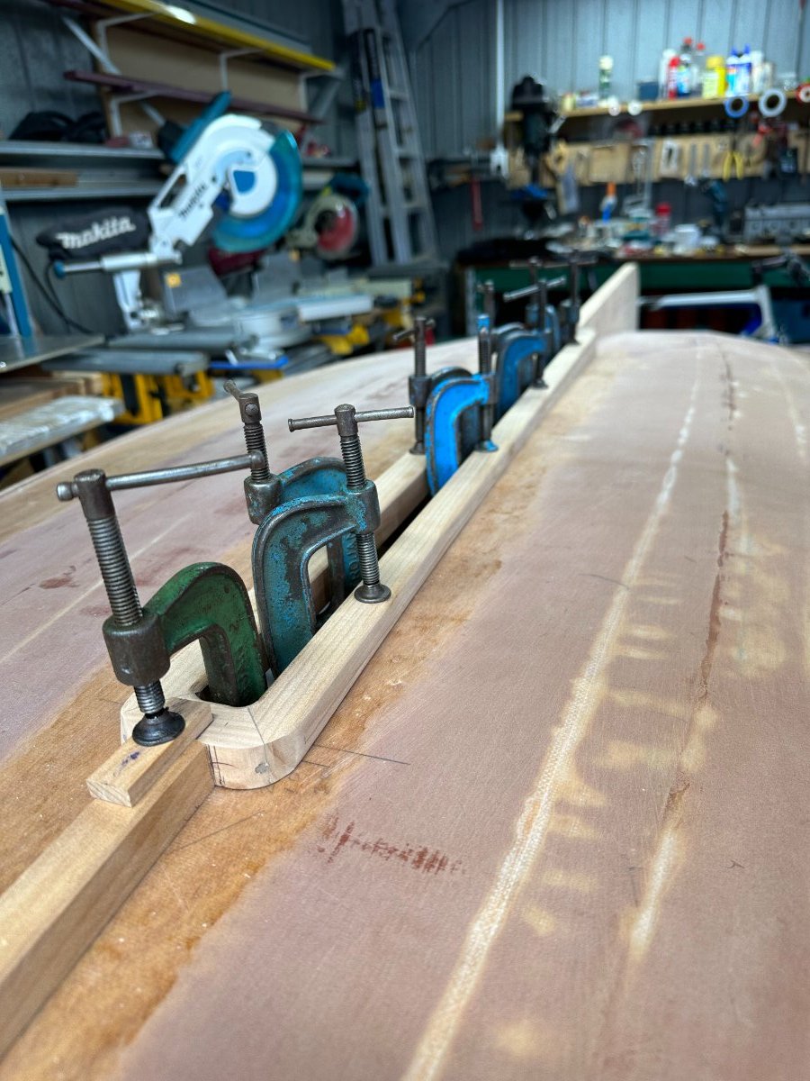

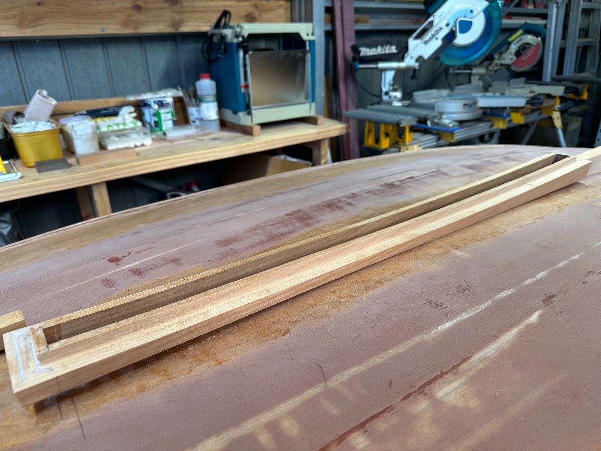

Priscilla II 450 Posted August 20, 2023 Author Share Posted August 20, 2023 Been a while not much progress on the Morby. The kitchen has turned biblical along with the garden so all I have managed is the extension to the skeg and a centreboard socket. Did my first steam bend and it worked well. Well fix off brass strips remove then sand fill paint sand fill paint and then release from build jig. Got a trailer so that's another thing to tick off. Still raining. 3 Quote Link to post Share on other sites
Black Panther 1,776 Posted August 21, 2023 Share Posted August 21, 2023 A man can never have too many clamps Quote Link to post Share on other sites
