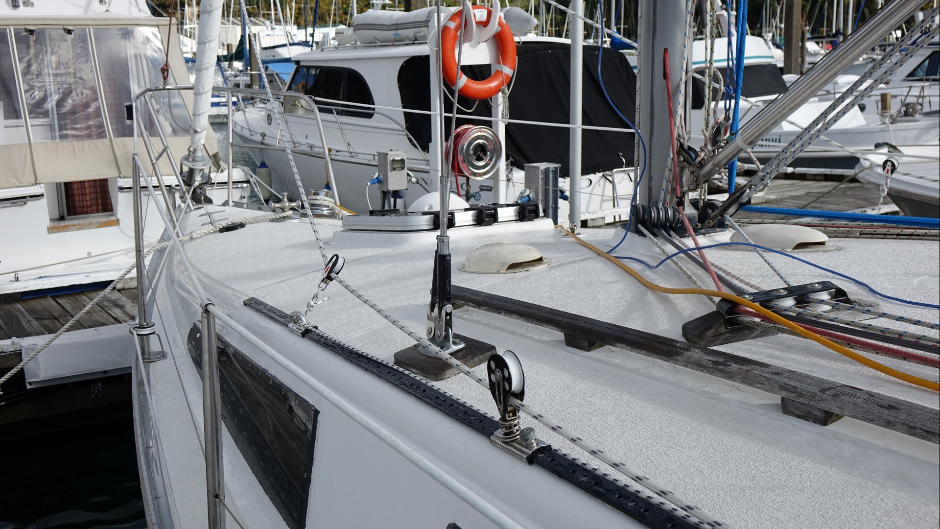

Johnish 0 Posted May 31, 2015 Author Share Posted May 31, 2015 Again, many thanks for the inputs; much appreciated. So I installed the so-called Barber-hauler kindly recommended by Aaron Blakemore, chief cook and bottle washer at Oddies Marine, Waikawa who also just happens to be one of the hottest serious large sailboat racing nutters in these waters. Here are a couple of photographs taken before leaving the marina and before experimenting and placing the cars in the correct position on the track. The line that tensions the block at right angles to the Genoa sheet cleats off in the cockpit as required. While I still like the 'towable car' solution I must admit that this is quick, inexpensive and easy. It should do the trick. We shall see. Comments most welcome. Cheers. Seems I screwed up adding the photographs. I shall resize them and try again. No, not having success therefore I have uploaded them to the front page of my web site. Dbl-click on the image to improve the view. johnmccully.com Link to post Share on other sites
PaulR 3 Posted June 2, 2015 Share Posted June 2, 2015 Simplicity is good, but everything depends upon the loads involved on nice days and the abuse expected in stormy weather. Yours looks fine. Link to post Share on other sites
Battleship 100 Posted June 2, 2015 Share Posted June 2, 2015 Good solution. Unless you have ball bearing tracks it's very difficult to get the cars to move under load if you modify them to make them towed. You might even consider the alloy thimbles at the sheet end and attach the blocks to the car for easy adjustment. Very simple, usually cheaper but not by as much as you would think and less weight bouncing around the deck when the sheet is flogging a bit whilst tacking or furling the sail. Link to post Share on other sites
Johnish 0 Posted June 3, 2015 Author Share Posted June 3, 2015 Thanks guys, much appreciated. Willow, I liked your suggestions a lot. I picked up a couple of plastic thimbles, $1.50 a piece, and relocated the block and attached it directly to the car as you suggested. Huge improvement. Many thank for your suggestion. Now if it stops raining and the wind picks up... Link to post Share on other sites
PaulR 3 Posted June 3, 2015 Share Posted June 3, 2015 Another consideration would be to use a snatch block or snap shackle so that the sheet / barber hauler can be led from OUTSIDE the lifelines by using your alloy toe rail. This would be a better solution when reaching as it would open the slot between mainsail and headsail wider. Perhaps using two barber haulers would make move the sheet outboard a lot easier and safer for solo sailors. Link to post Share on other sites
Johnish 0 Posted June 4, 2015 Author Share Posted June 4, 2015 Willow's suggestion implemented (photograph attached), Nothing but a small plastic thimble flapping about on the foredeck now. When the rain takes a break and the wind gets up again I shall test the system. PaulR, when I get this barber hauler up and working to my satisfaction I shall look at your suggestion, many thanks. Cheers... Link to post Share on other sites
