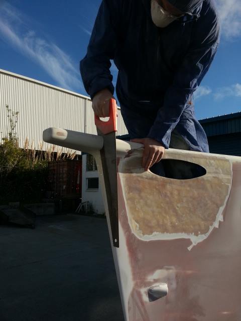

nolipoli 0 Posted October 29, 2018 Author Share Posted October 29, 2018 Luckily my boat already has a through hull rudder, so no mods required there. I could literally just cut the transom open between the seats and patch the holes (Properly of course). I am pretty handy, having previously design and manufactured furniture for a living, using Timber, Stainless steel, Aluminium and glass. Unfortunately I have almost no experience in Fiberglass. I thought I could probably build a deck like this one. Quote Link to post Share on other sites

nolipoli 0 Posted November 3, 2018 Author Share Posted November 3, 2018 Thanks for all the feedback guys. For now I have decided to just build a Swim/boarding platform, and maybe do the transom cut when I’ve had an opportunity to do some glassing on a less precious item than my 830. I’d hate to live with having butchered one. NZTiger that looks good. I am keen to see it (probably a weekend less blowy than this one. Mattm have you got pics of your swim platform? I’d love to see it. Funlovincriminal, was this on Trademe recently? Stunning! Quote Link to post Share on other sites

nolipoli 0 Posted December 10, 2018 Author Share Posted December 10, 2018 This is the final result. A bit of cleaning up and it'll be pretty as. Quote Link to post Share on other sites
