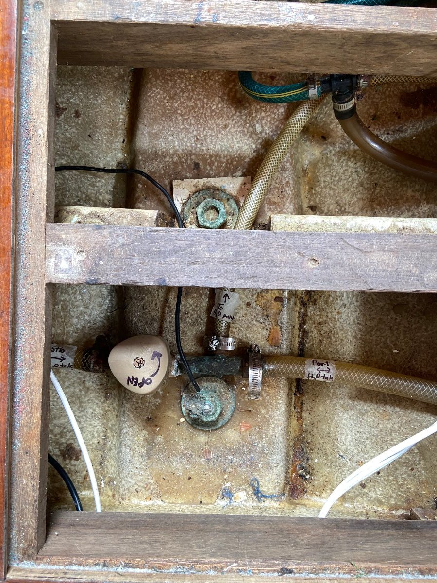

dmac 0 Posted August 2, 2025 Share Posted August 2, 2025 I've got a keel bolt question for my Cav32. Mine was built in 1974 so mid to later end of the production line. When I purchased it, it had a rectangular fibreglass packer around the aft most keel bolt (top of the image) which intersected the timber/fibreglass stringer. Only about half the threads where in contact with the bolt and I think some glue at the top of the both helped to fix it in place. I'd always thought this was some temp maintenance patch job that previous owner/s never got around to fixing. However, I've since removed the 5mm fibreglass packer expecting to see some reason for it underneath in the bilge like cracks or something else, but I thought given the close distance to the stringer this could be from the construction? Could the stringer could have been accidentally installed too close to the aft keelbolt? The distance certainly wouldn't give much room for the stainless washer of the same size as the other keel bolts. Unless it was partially encapsulated? I've seen other examples of encapsulated bolts such as some of the headsail car bolts intersecting the galley cabinets - so it wouldn't surprise me if this is the case. Or did they come out of the factory with very minimal washers? Anyway, my second and more important question is - to remedy this, can I put the stainless washer in place like the other keelbolts even if it covers the stringer and the glass? Or should I glass across the cut stringer to reinforce where it has been cut? This is assuming there's no cracks (none that I could see this evening in the dim light anyway). Quote Link to post Share on other sites
Pecco 12 Posted August 4, 2025 Author Share Posted August 4, 2025 On 2/08/2025 at 8:30 PM, dmac said: Hi there, I am not sure why two bolts are so close by. On my cav they are way more spaced out. I believe from memory there is 5 in total. Regarding the stringer, I would not think such a cut out would be a good thing but, what do I know??? It looks like it has been there forever though... It is certainly odd. Cheers On 2/08/2025 at 8:30 PM, dmac said: reason fhhhhor it underneath in the bilge like cracks or something else, but I thought given the close distance to the stringer this could be from the construction? Could the stringer could have been accidentally installed too close to the aft keelbolt? The distance certainly wouldn't give much room for the stainless washer of the same size as the other keel bolts. Unless it was partially encapsulated? I've seen other examples of encapsulated bolts such as some of the headsail car bolts intersecting the galley Quote Link to post Share on other sites
