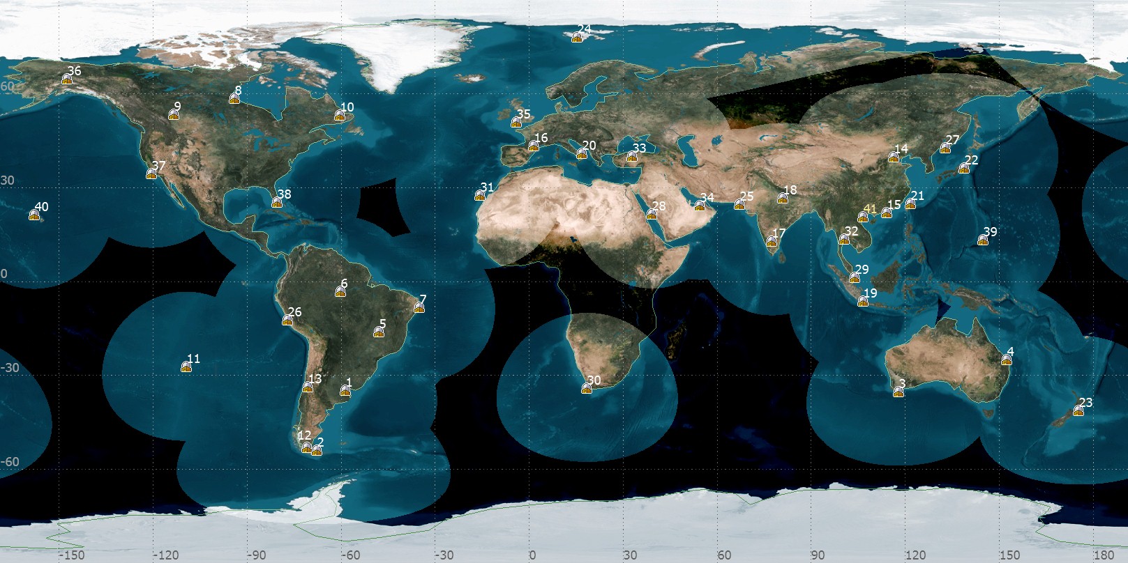

rigger 47 Posted May 23, 2015 Share Posted May 23, 2015 For those wanting further info re coverage see: https://www.cospas-sarsat.int/en/system-overview/detailed-cospas-sarsat-system-description Take a look around. geo sat coverage https://www.cospas-sarsat.int/en/system/detailed-system-description/geosar-satellite-coverage Leo sat coverage Link to post Share on other sites
