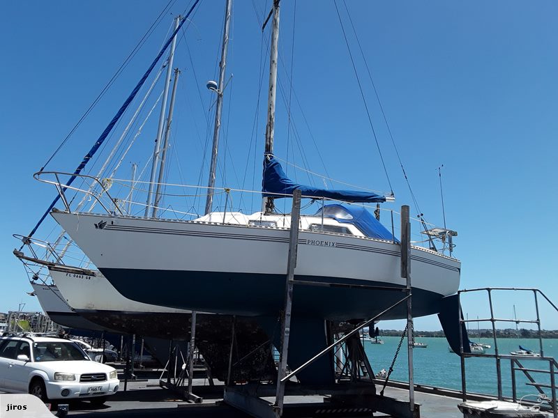

Island Time 1,355 Posted January 22, 2017 Share Posted January 22, 2017 Here's a pic showing wll. Boat specs says wll is 22ft. Quote Link to post Share on other sites
Muzza 18 Posted January 22, 2017 Share Posted January 22, 2017 Here's a pic showing wll. Boat specs says wll is 22ft.IMG_0408.JPG I think that may not be the Cav 26 Bob salthouse bought out his 25 at the same time and that looks more like the SH25 Quote Link to post Share on other sites
ScarecrowR31 8 Posted January 22, 2017 Share Posted January 22, 2017 Yes its a Salthouse not a Cav 1 Quote Link to post Share on other sites
Muzza 18 Posted January 22, 2017 Share Posted January 22, 2017 The cav 26 looks totally different, for its time more performance orientated. The 25 stands out as a Salthouse design, for once Boat Data has it wrong. I think where the confusion comes from both were made by Salthouse's later Cavalier yachts. Quote Link to post Share on other sites
Island Time 1,355 Posted January 22, 2017 Share Posted January 22, 2017 Ok, looks like that's right, wrongly labeled pic. Try this one : Quote Link to post Share on other sites
Muzza 18 Posted January 22, 2017 Share Posted January 22, 2017 yep that's a Cav 26. Sail drive makes sense on that boat moving the prop at least 6 ft further forward than a shaft installation. Unfortunately sail drive manufacturers don't put low enough reductions on for engines running to 3,600 rpm Yanmar 2.64:1 Nanni and I think Beta 2.38:1 and Lombardini 2.18:1. a 3:1 would be better suited get max prop revs down to 1200 and cruising down to 1000 or just over. Quote Link to post Share on other sites
