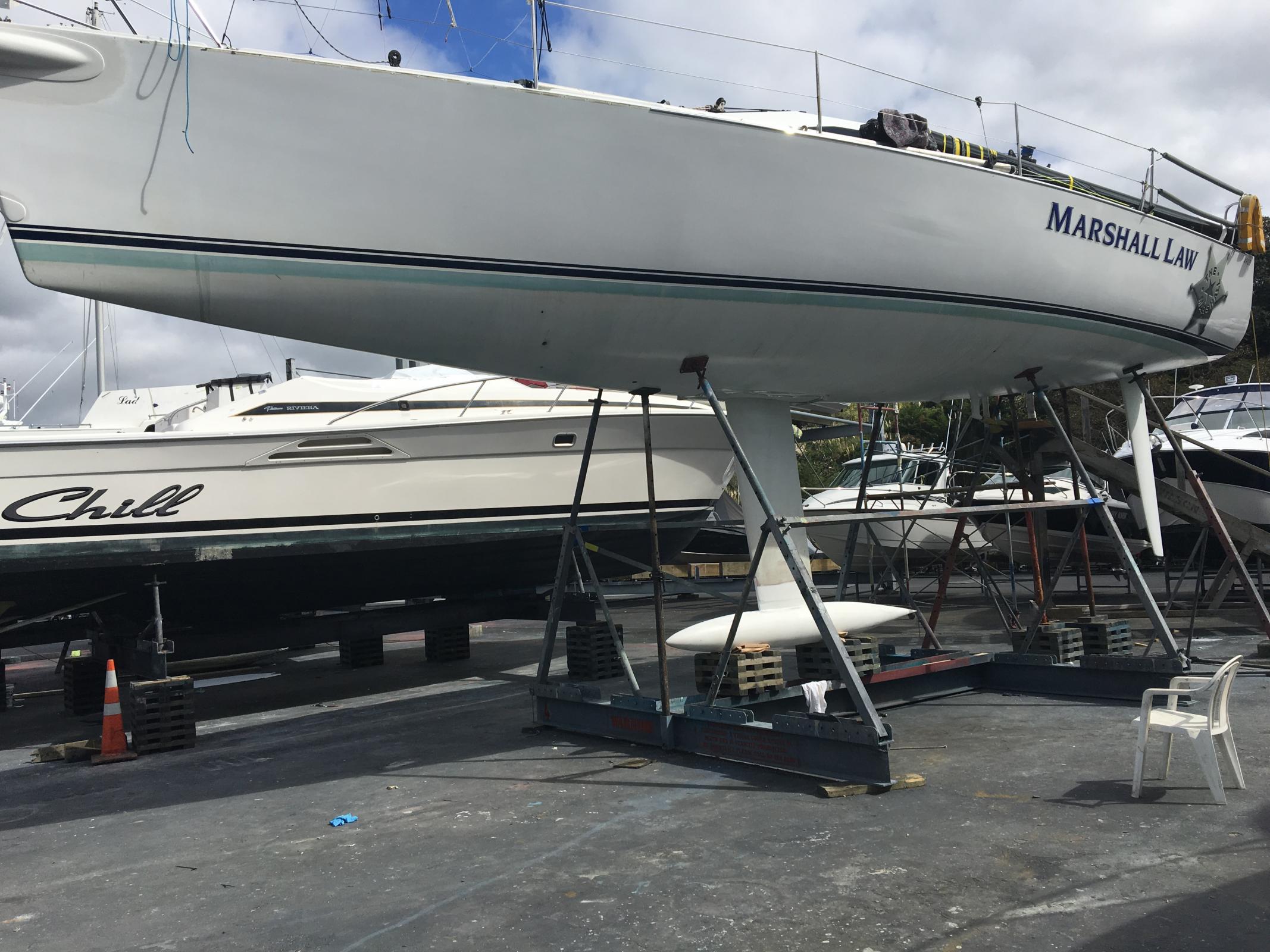

ballystick 79 Posted September 2, 2016 Share Posted September 2, 2016 What did you do with the old one (bulb) and how heavy was it? Quote Link to post Share on other sites
floatsome 0 Posted September 2, 2016 Share Posted September 2, 2016 Who designed the keel? Quote Link to post Share on other sites
smithy09 50 Posted September 4, 2016 Share Posted September 4, 2016 What did you do with the old one (bulb) and how heavy was it? Melted the old bulb into the new one! Old bulb was 1650kg. New bulb is 1900kg. Poor man's way of getting a little extra righting moment. Quote Link to post Share on other sites
smithy09 50 Posted September 4, 2016 Share Posted September 4, 2016 Who designed the keel? The old fin is a Valium design by Ian Vickers. The new bulb is Kevin Dibley, as is the bowsprit. Quote Link to post Share on other sites

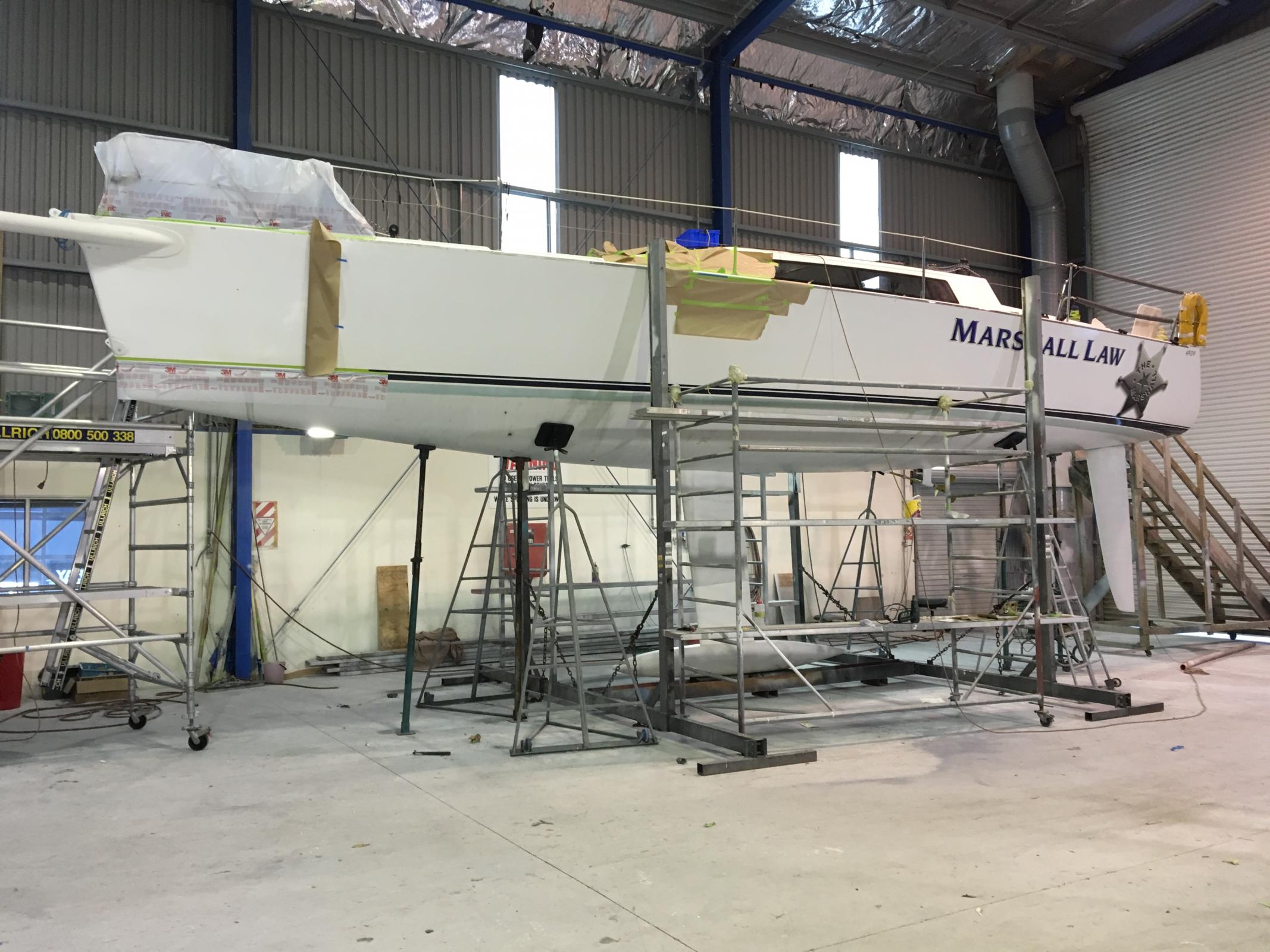

smithy09 50 Posted September 9, 2016 Share Posted September 9, 2016 Stripped for painting.. Nice to be undercover for this... Quote Link to post Share on other sites
ScottiE 174 Posted September 9, 2016 Share Posted September 9, 2016 sand sand sand! Quote Link to post Share on other sites
smithy09 50 Posted September 9, 2016 Share Posted September 9, 2016 It's already got paint? .......... maybe it's just me working off a lower base due to my boat's glamour paint work {insert Tui advert here} The cockpit is a lot rougher than it looks in the photos. Prod is only undercoat.. Quote Link to post Share on other sites
