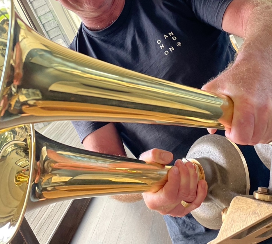

What are the clubs using as start boat horns? Loud haulers? Chrome horns?
Anyone know of a club using something a bit smarter in terms of automatic 5, 4, 1 go signals? Such as the Autohoot, sailbot, Ollie Horn or Regatta Pro Start?
I’m trying to find the best option for a new boat being built for the club I belong to. It would be nice to find a locally available option for automated tooting.
Shy of importing something from the US or EU, or making a tone generator for a loud hailer myself, it’s hard to see a good option, other than just a pair of horns and a button.

Thanks DP. So it’s as simple as the horn toots when the button is pressed?
Yes HT, but my task isn’t related to what ‘real sailors’ might do. It’s to find a new horn / horn system for the new boat. Sound signals are quite useful, and I’d like the system used to be both loud, thus clearly audible from a distance, in a breeze, and no more taxing on the committee boat crew than reasonably necessary 👍

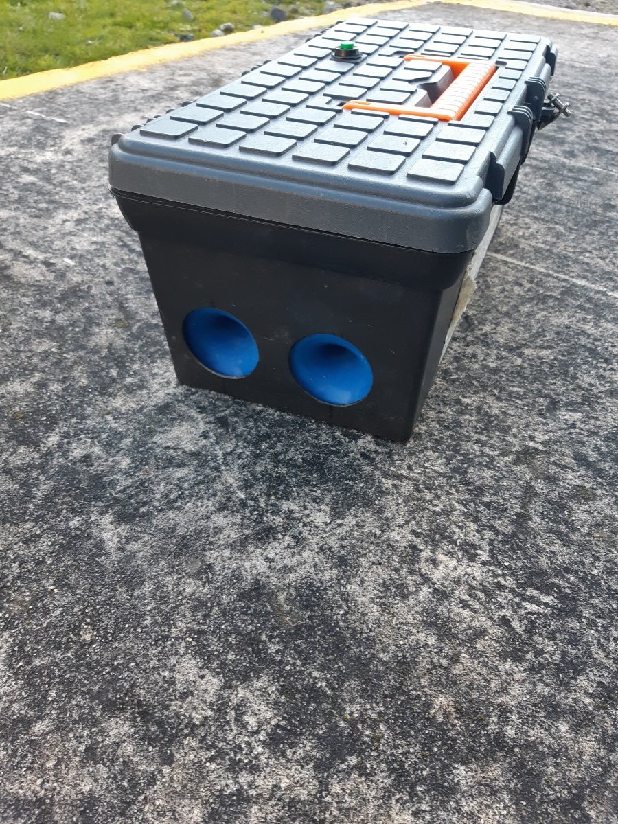

Hey Matt:
i have a 12v horn set up similar to DPs photo which I would be happy to donate to Your club. Had it from when I was doing RO duties a couple years ago.
it has a push button as well as 2 handheld remotes to activate the horn.
give me a PM if interested

Interested in the setup and of  “remotes “
did you make it yourself ?
Yes made it myself, I’ll get a photo when I can. Has a remote receiver wired in to activate horn.
