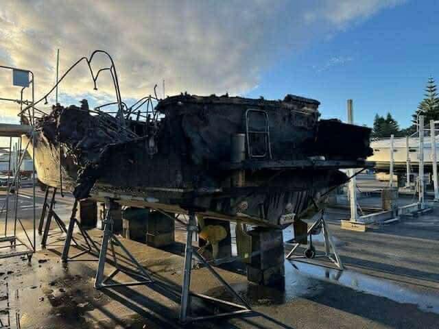

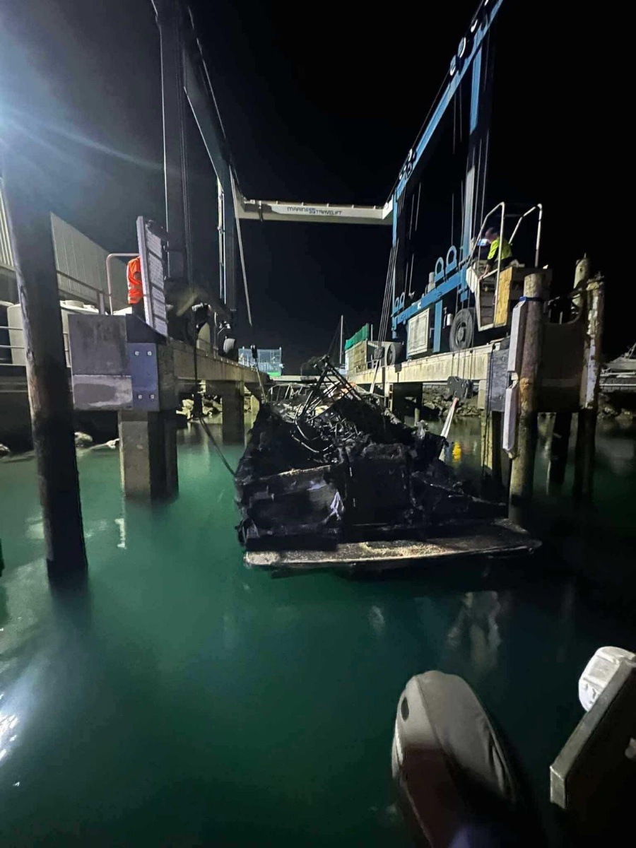

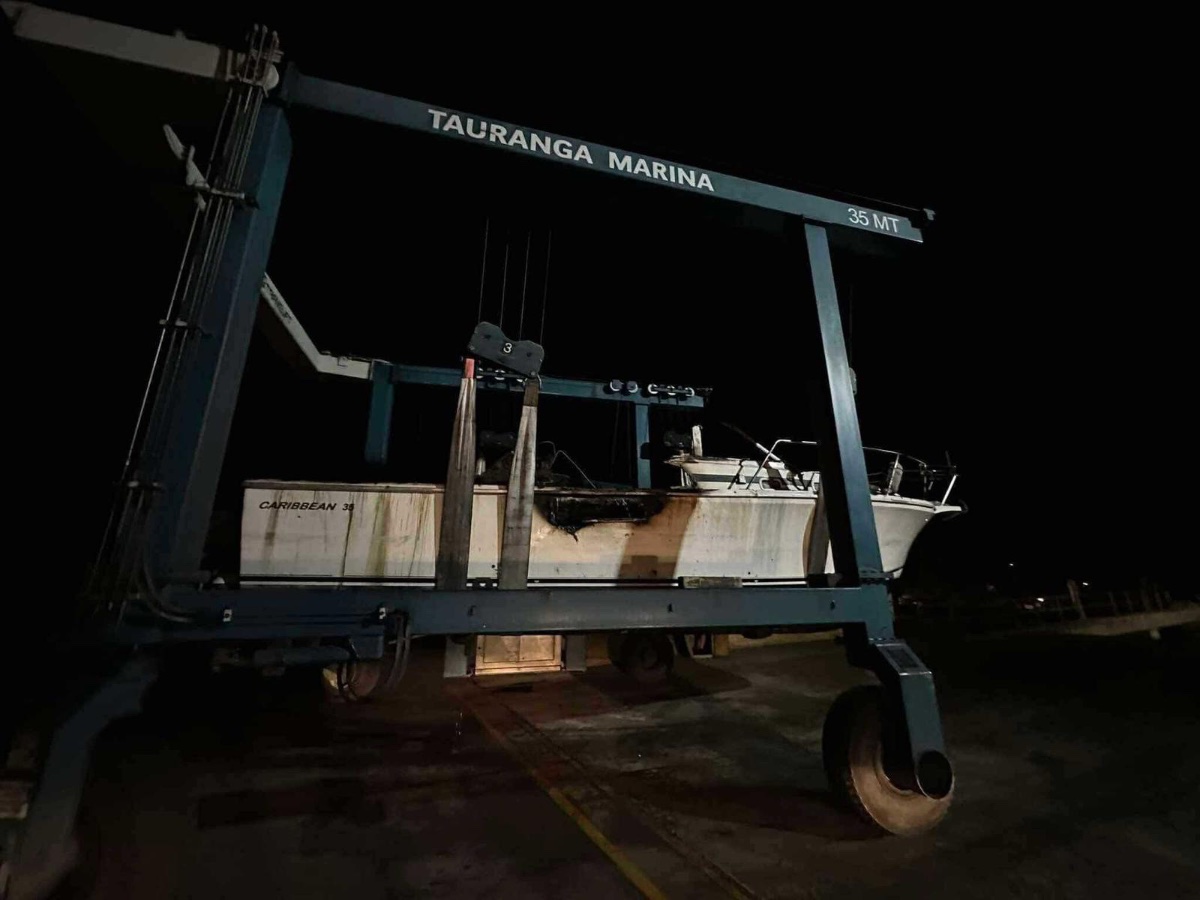

eruptn 111 Posted March 4, 2025 Share Posted March 4, 2025 Fire started on launch, 4 boats very damaged…others near by will be impacted as well as floating finger. Quote Link to post Share on other sites

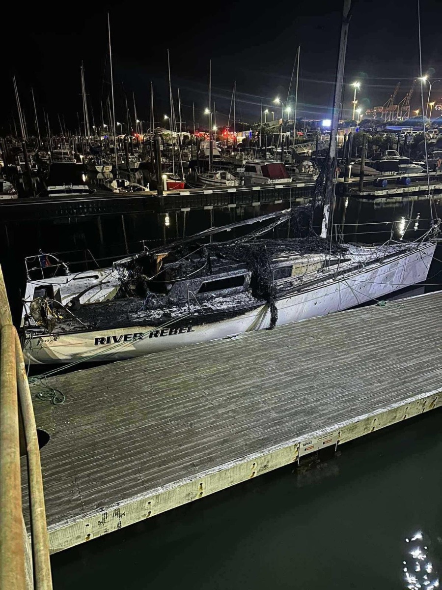

ex Elly 276 Posted March 5, 2025 Share Posted March 5, 2025 Wow! Is River Rebel salvageable? What is the name of the other yacht? Quote Link to post Share on other sites
ballystick 83 Posted March 5, 2025 Share Posted March 5, 2025 River Rebel's sails, boom, chainplates all gone, must have been hot - doesn't look to be salvageable. Fire was in a launch nearby. Quote Link to post Share on other sites
waikiore 522 Posted March 5, 2025 Share Posted March 5, 2025 I wonder if the launch had Lithium ? Looks as if started in the engine area and this follows other incidents where the BMS failed in NZ and offshore. Quote Link to post Share on other sites
ballystick 83 Posted March 5, 2025 Share Posted March 5, 2025 The boat that appeared to be the source was fitted with Lead Crystal batteries previously, unsure if they were still there, it was a large cost at that time, I don't know much about them except that they were costly Quote Link to post Share on other sites
Cameron 110 Posted March 7, 2025 Share Posted March 7, 2025 There is a rumour the launch was having electrical work done by a guy on the piss... Quote Link to post Share on other sites
Island Time 1,347 Posted March 7, 2025 Share Posted March 7, 2025 On 5/03/2025 at 3:03 PM, waikiore said: I wonder if the launch had Lithium ? Looks as if started in the engine area and this follows other incidents where the BMS failed in NZ and offshore. I'd be interested to read of any incident with LIFEPO4 batteries being identified as the cause of ANY fire, ashore or afloat, BMS failure or not. LifePo4 batts are VERY hard to make burn (ABYC tried to do it and couldn't) - other Lithium chemistries have no place on a boat IMO. 1 2 Quote Link to post Share on other sites

ballystick 83 Posted March 17, 2025 Share Posted March 17, 2025 Back to the fire, if it was batteries then I would have thought that the water applied would not have affected the battery fire and the boat would have burnt until it sank. In this case the fire crew managed to douse the fire without sinking the boats. Initial investigation have been around the shore power wiring starting the fire with further testing to confirm this. Quote Link to post Share on other sites
