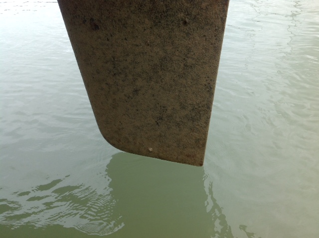

Fish 0 Posted November 27, 2015 Share Posted November 27, 2015 Photos of copper coat, first clean in 20 months. Last dried out end of March 2014. Basically no grass, small handful of barnacles. 'normal' slime and not much else. Note the prop shaft did have mussels growing on it, and the prop needed attention also. Very pleased with the performance of copper coat. Boat had very little use of this period. Boat cleaned and photos taken 26th November 2015. Quote Link to post Share on other sites

Battleship 100 Posted November 27, 2015 Author Share Posted November 27, 2015 Funny how people have different idea about how much growth is acceptable, I would sleep at night if my boat was a dirty as the previous photos. I get annoyed about a small layer of slime. The last few years I have been using a light grey wet and forget antifoul. Snigger if you like but it works really well and is only a quarter of the price of 66. I usually haul once every 6 months for a clean and do a re coat about every 18 months but am very fussy about keeping it clean so brush every couple of weeks in the summer. Quote Link to post Share on other sites
