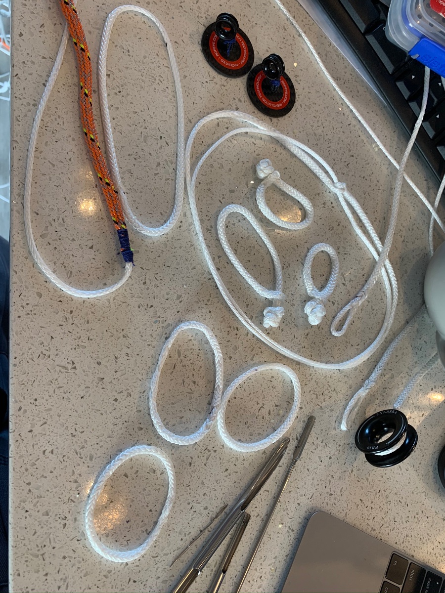

Psyche 843 Posted February 5, 2022 Share Posted February 5, 2022 I make them regularly, theres a good knot app called Grogs Animated Knots that happens to have step by step instructions for 2 different styles. I use this design; Quote Link to post Share on other sites
ballystick 79 Posted February 5, 2022 Share Posted February 5, 2022 https://www.youtube.com/watch?v=SputIoiCkT0 I made them integrated into the sheets so that it can't be dropped and is neat and tidy, there are several Youtube videos showing how to construct them. They've been good and also for our lightweight spinnaker sheets too. 1 Quote Link to post Share on other sites

Sudden5869 19 Posted February 5, 2022 Share Posted February 5, 2022 I've found these instructions really helpful. https://l-36.com/soft_shackle_9.php Great little calculator to help with measurements and sizings. Added them to new Genoa / Jib Sheets. A small eye splice on the sheet means the soft shackle fits in tightly and stays there permanently. Agree with Carpe Diem. They take two hands, to attach and remove, which can be a drawback. Quote Link to post Share on other sites
