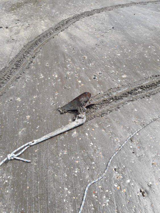

Finally moved on this - Manson Supreme will replace the plough.
So much conflicting advice (not here, everywhere!) although consistent is that more chain is good and modern anchors outperform older designs.
Anyone want an old plough anchor?
